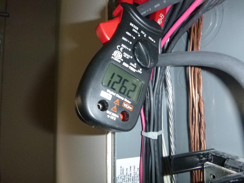

New construction 1800 sf condo 125 amp service
All electric, no gas
10kw heat pump, compressor, water heater and range all running. No dryer to test.
Got 126 amp draw. 😃

Considering the artificial conditions you created I don’t see any value to those figures.

Did that master electrician do a load calculation?

Because people never use use hot water cook and heat at the same time?
My 200A mains usually trip once or twice a winter. I would have liked to know that they might do that when I bought the house.

I say it is wrong . And yes all the above could be on , I would say someone fu

I don’t do load-calcs, but my understanding is that the service should be sized to accommodate a percentage (not 100%) of the maximum potential load. There is a whole “formula” to a proper load calculation, which is above my pay grade 😃
I wouldn’t make a judgement call on this without running past someone who knows how to do these calculations.

The only call I made is a secondary review to ensure proper sizing. NO repairs or corrections at this point, just really unusual for the build.
Talked with a state inspector who are the ones who make the calls in regards to this, and he said he would have to come take a look at this one once he found out all the information.

When I do my inspections, everything is on for the very reason Chuck mentioned. I have had a few homes where the main did trip.
There is an excel load calculation sheet out on the net. I have a copy.

A demand load calculation is the only proper way to size a service. Not a trumped up lets turn everything on and see if the main trips. Using that method you could say every circuit in the house is too small by plugging in multiple space heaters on high.

Have you checked the ampacity being drawn or for other problems in the panel? Sounds like it is time for some diagnostics. A properly sized service should not be doing this.
A breaker will typically hold 125% for over an hour depending on how fast it gets to capacity.

Am I missing something? How is this a question of right or wrong? If there is 126 amp draw coming through a 125 amp service without the main tripping, how is that not wrong?

Search “breaker trip curves”. As I said above a breaker will hold quite a bit more than its rating for a substantial period of time. A breaker simply does not trip at .1 over the rating.

Sizes out to 112 amp service. Note: 100 is the smallest allowed for a dwelling.

It may not be wrong because the testing procedure was flawed. Standard load calculations take into account load diversity where not every given load will be on at the same time. The test used here lacks diversity.

Is the assumption that a load like Sean applied would not remain for the length of time needed to trip the main (e.g. the water heater would cycle off, the dryer cycle would end) so it’s not logical to assume that load in a normal household setting?
