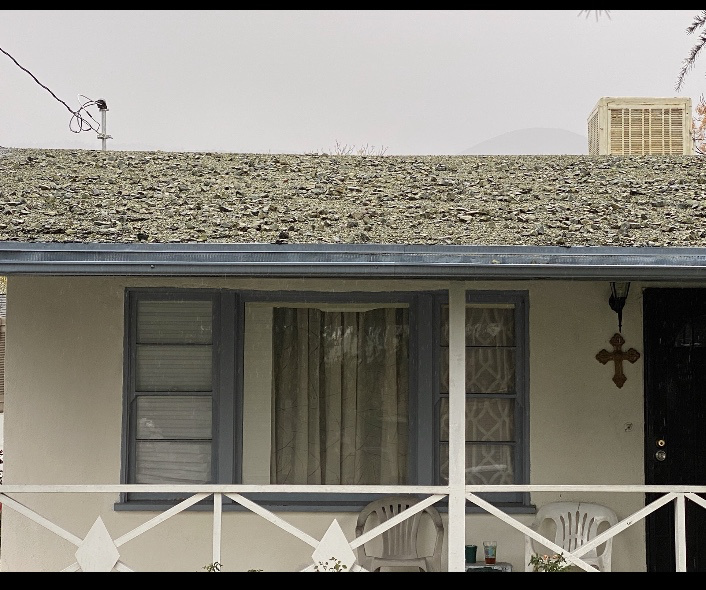

Rock Roof ... Need Help
Anybody seen this type of construction on a roof.
I’ve seen small rocks …( pea gravel ) …
This one has alot of larger rocks.

I don’t see any problem with that, David. With that slope, smaller stones may get blown around or off…JMHO.

Ok I’ll bite. Why would you put gravel ballast on a pitched roof.

Might be Inverted BUR system. Typically/Usually ballast is 3/4".
Inverted roofs. 4 to 5 Plies saturated felt, rigid foam board and ballast. Ballast can be any type of stone. Remember through. The rounder smoother the shape, the higher the possibility of moving downstream with rain or wind events. The gravel stopper flashing should be as high at the aggregate.

As A licensed roofer back in the day, typically 1/4" inch gravel is used on low slope roof decks.
Gravel stopper flashing impeded aggregate from being displaced. During heavy rains columns of water can displace aggregate but typically gutters are hung at the eave and catch displaced aggregate. Displaced aggregate can be easy collected and rebroadcast back onto the roof.
That roof ‘may require gutters.’
