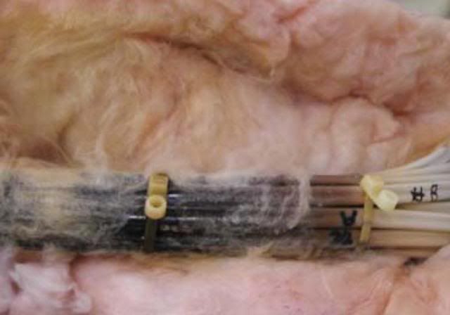

Pictorial example of why bundling large groups of romexes for a good distance can be bad:
Was it the amount of connected electricity that caused it??
No. Heat causes what you’re looking at.
Interesting
Marc,
Great pic and example, thanx
I believe they should be derated when bundled over long distances. In the past, there were a couple of good threads on the subject over at inspectionnews.com. In fact, I think one is ongoing currently.
