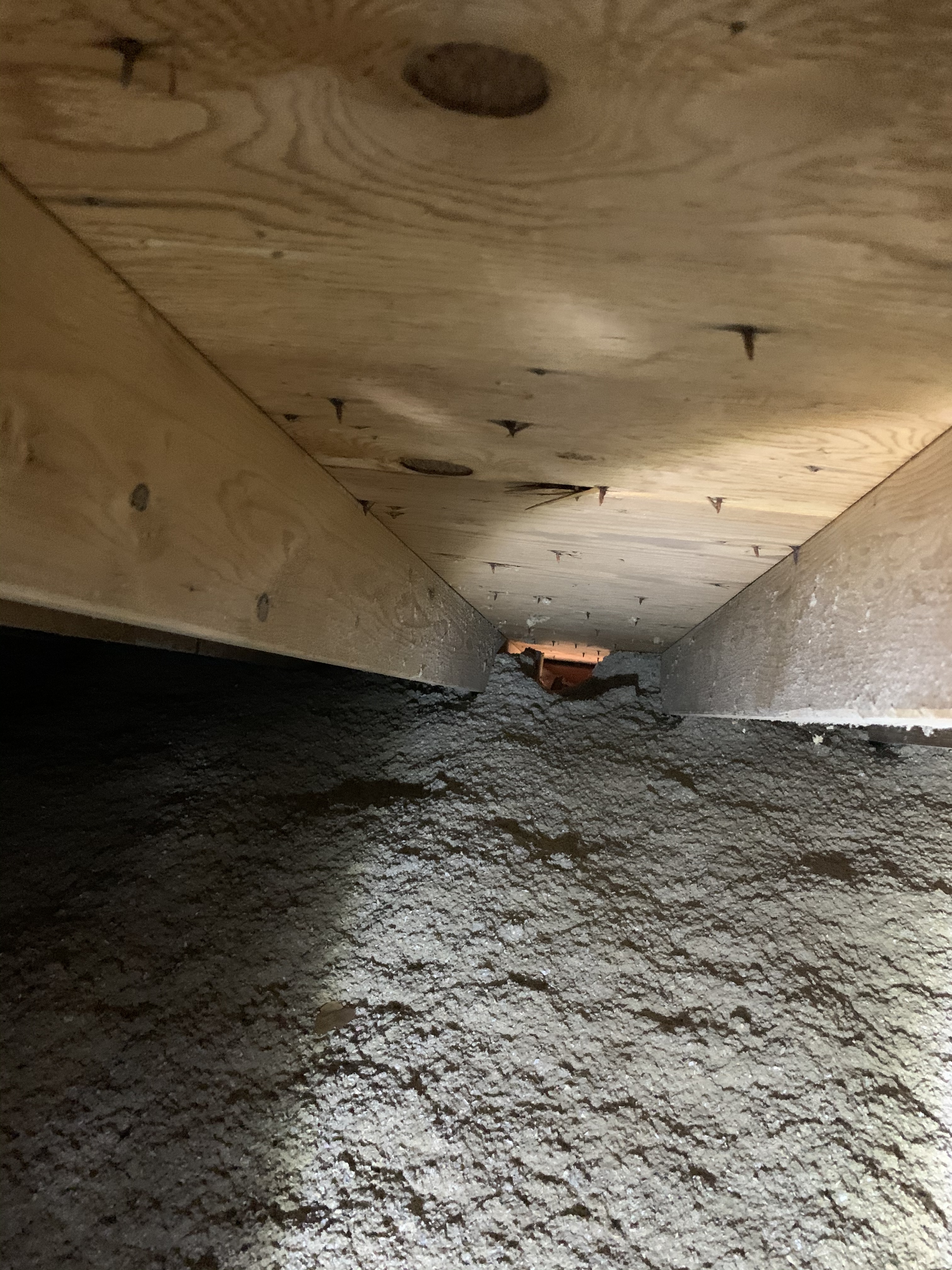

It’s 2~ sq" for the center vent (shown in OP’s pic)… 6~sq" is for full perforated 4"x3=12" wide profile soffit.
You do have a point, however, most HI will not do any maths or take this into account, easily overlooked and quickly deferred to the SOP because we’re not engineers!
No the bathrooms are on the other half of the ridge and are vented properly, and I do know that soffit is actually open and not just slapped over top of old painted plywood soffits
There are no gable vents, what concerns me is that the shingles never dry out over that section of the roof and I was wondering if they are so saturated that it’s seeping through possibly underlayment and soaking into the roof sheathing, but the roof sheathing still felt pretty solid, A screwdriver would not stab into it but maybe the depth of a dime, That is Also why it was making me think the dampness could be coming from inside the attic and maybe needed the airflow. The damp framing in the attic was directly under the part of the asphalt shingles that seems to never dry up and is growing moss
I don’t have an educated answer or explanation for that occurring. There might be some ventilation issues, but that would not explain roof shingles to never dry out.
I have heard of moisture trapped under the shingles that don’t dry out, but never heard of shingles to never dry out even after a rain.
Maybe a roofing manufacturer could shed some light on something like that. I can’t see a roofing contractor to help you much on that, but there is nothing to lose I guess. They can guess as well as us. LOL
Make a recommendation for further evaluation by a general contractor and they might have a resource to someone that knows the cause, at least you would be out of it.
Report whatever else you see and call it good.
There are three vents on the back side of the roof in the first picture, but I don’t think it is enough and might contribute to the problem.

Inadequate roof deck venting.
Poor attic circulation.

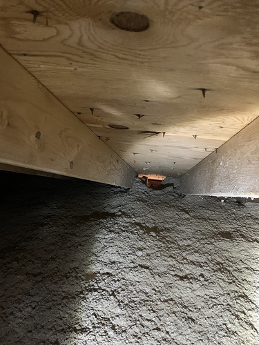

Blocked eave vents. Blown in cellulose insulation over eaves.
No insulation eave dams. Suspect: Microbial growth on sheathing. Microbial growth on rafters.
High humidity.
Recommend: A licensed IAC2 contractor, an indoor air quality contractor, to perform a microbial survey in the attic. Recommend: A licensed roofing contractor install adequate roof deck vents. Recommend: A licensed insulation contractor improve eave venting. Act upon any recommendations therein for all above.
