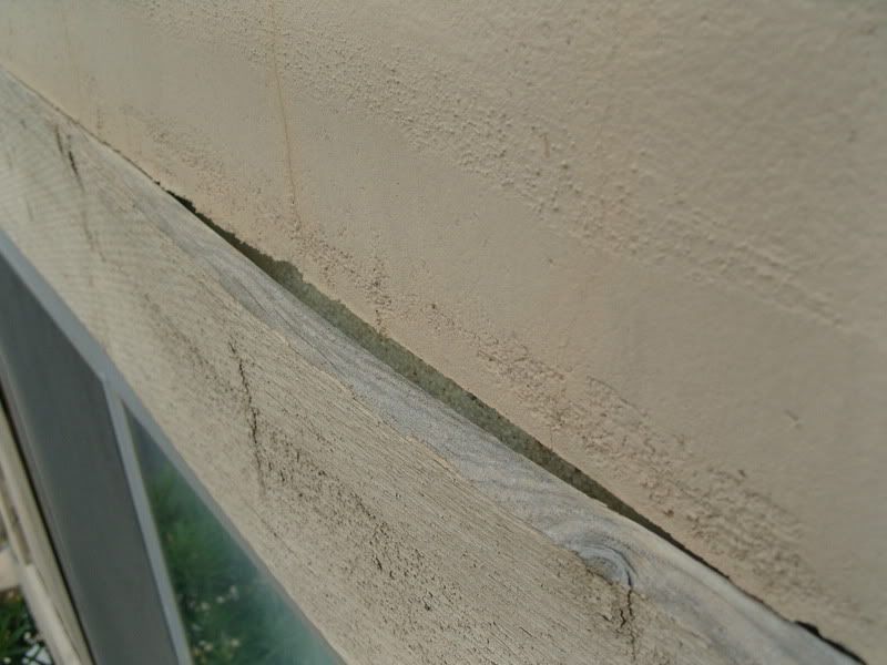

The only window in every building with wood trim at the header is in the front, all the other windows in every building have stucco, except the one…very weird design…but anyway…I think for another $9,779.00 I will ask to scan every window from the interior where there is wood trim warping allowing rain to come in…I’m sure they will go for it, and I will get a free Cam out of the deal—::)))
Here is the Warped Wood Trim above the one window in every building.
[http://i74.photobucket.com/albums/i247/badstucco1/8108BComierPotter111.jpg](http://i74.photobucket.com/albums/i247/badstucco1/8108BComierPotter111.jpg)

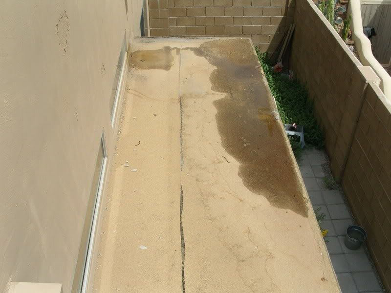

And the Condensation Drain Lines terminating through a scupper and dropping onto a rear patio roof.
[http://i74.photobucket.com/albums/i247/badstucco1/8108BComierPotter080.jpg](http://i74.photobucket.com/albums/i247/badstucco1/8108BComierPotter080.jpg)
[http://i74.photobucket.com/albums/i247/badstucco1/8108BComierPotter078.jpg](http://i74.photobucket.com/albums/i247/badstucco1/8108BComierPotter078.jpg)

The warped wood above the windows appears to be “interior grade” wood that would be highly absorbent to rainwater. Plus… I do not see any type of “Vapor Barrier” or flashing.
Also I do not see how it was nailed / fastened to the exterior wall.
Looks to me like you might have a “Gold Mine” on your hands!😛
If you go into the attics look for the _lack of_ “Fire wall” separations between the units.
PS:
On the last two pics the “seams” look worn and like they are ready to “fail / split”.
Also… the “Drain Water” is ponding… I would recommend building up that small section so that the water drains off of the roof.

They all have flat low-sloped roofs, there is no attic.
I did not see any moist-stop or vapor barrier either around this window
If they didn’t forget to nail that trim above the window I would of never found the construction defect, so the owners will be happy with my findings when I present them at the HOA Meeting to come…!!
> PS:
Yes, the patio roofs have issues also, they always use the wrong type of drip edge flashing here which is designed for built-up roofs, where more than one layer of roofing material would be used, thus, bringing the roof covering surface to the top of the drip edge, but too late now, add more torch-down or the water will pond until it finds an exit through the roof covering when it finally fails—😃

Linas,
What were the other installation issue’s?
If you do not mind sharing.
<div class="post-metadata">
**Author:** ![ldapkus](https://sea2.discourse-cdn.com/internachi/user_avatar/forum.nachi.org/ldapkus/32/58272_2.png) [@ldapkus](https://forum.nachi.org/u/ldapkus)\
**Post date:** [August 15, 2008, 12:33am UTC](https://forum.nachi.org/t/roof-inspections/30944/19 "2008-08-15T00:33:42Z")
</div>
They are vinly windows and since the weeps were not draining properly the water was entering the framing and working it’s way downward through through cracks around the sill attachment points.
