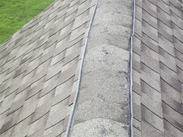

Here’s a good one and why I walk roofs. Full dormered Cape with new roof??? Looked good on the front.
Guess they forgot to do the back.

That’s insane. Why would anyone go through the trouble of re-roofing just one side? Maybe that’s the “new” standard for “House Staging”??

Was probably a dispute between the owner and roofer…so he only received half a roof. lol
Yep… Gotta get up on those roofs, or at the very least, get on a ladder at the gutter level to be sure that you don’t miss something that big! Ouch !!!

Is that rolled roofing on the other side?
I still do not understand why inspectors walk on roofs, risk damage to someone else’s roof, and falls and injuries to themselves. I can see all you see from your pictures via binocculars or by ladder at gutter edges. I right up this stuff often. Very common here. My binocculars are so powerful, often I have to step back to get a clear view of the roof and chimney. Bushnell Perma-Focus 10x50.
Yes, it was!!!
Gary, couldn’t see this roof from the ground. Walk out basement with two stories above that, needed a 32’ ladder which I didn’t have with me.
I have never actually seen rolled roofing. Is that proper flashing on the plumbing stack for a flat rolled roof?

Not exactly but believe it or not it wasn’t leaking… Yet.
Good catch! I have seen this done a couple of times. Street side looks brand new, and the back is worn out. Things are not always what they seem.

Any rolled roofing, new or old, should be written up, IMO. I have yet to see rolled roofing installed properly.
