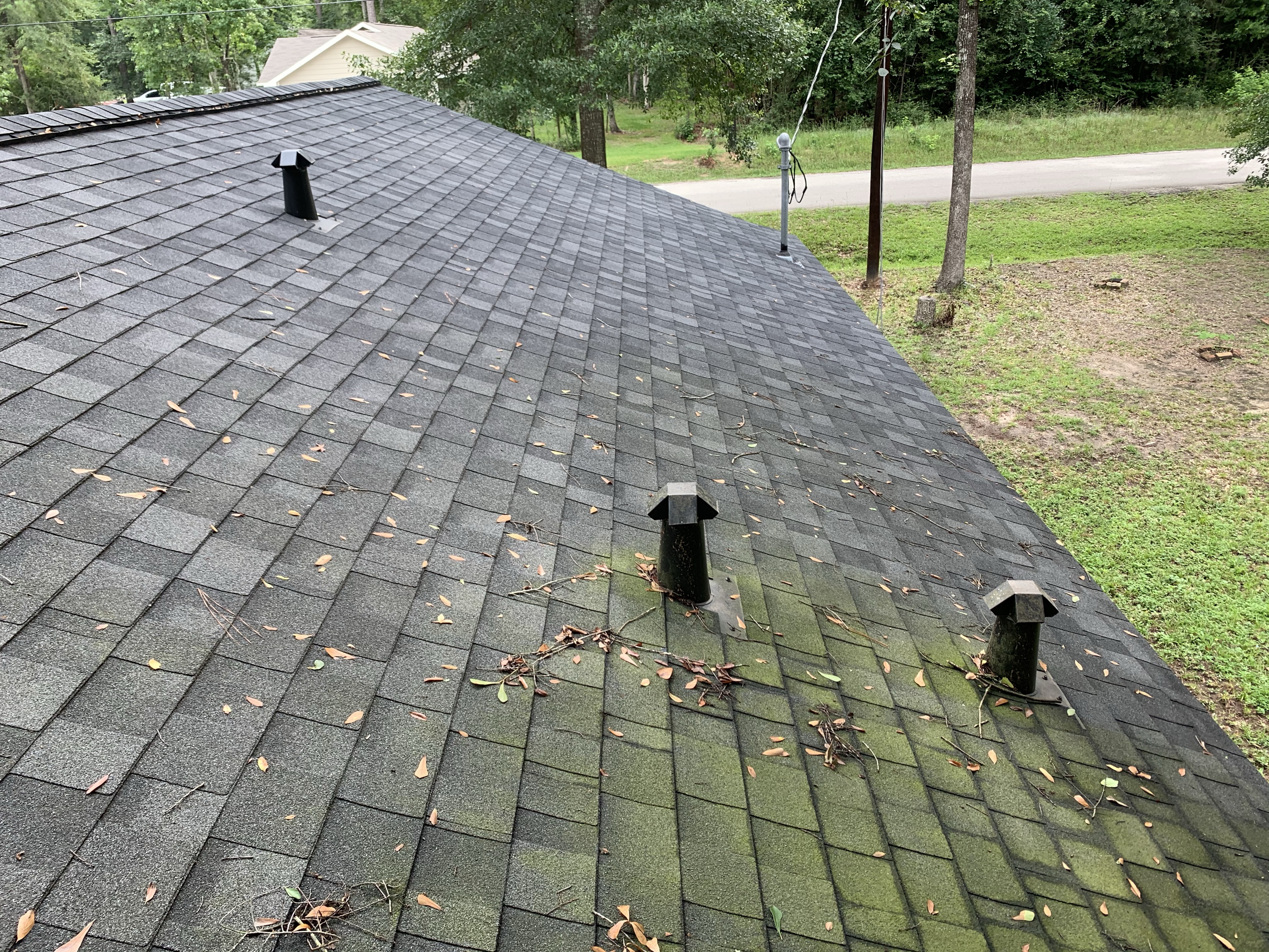

Inspected a house today with a 3 year old laminated asphalt shingle roof. Each of the plumbing PVC vent pipes terminated into a roof jack with vent cap flashing assembly. Oddly enough, I have never seen this type of flashing used for plumbing vent pipes before. I cant think of any problem with using this type of flashing other than the possibility of the pipe extending too far into the roof jack but each pipe appeared to have sufficient clearance from the underside of the vent. Just wanted make sure I was not missing anything.

I don’t see a roof jack in that picture, and I would be concerned if I did.
I think you meant to write “vent pipe flashing”, or the sometimes-used slang “jack boot”, which goes on the roof.
But a “roof jack” is something different entirely than what you appear to be concerned about.
Please check your terms so we know what you are really asking.

As you eluded, terminology for a particular item can vary. If you are confused about a term, maybe you should ask for clarification instead of trying to school me. I think the information and pictures I provided are pretty self explanatory for you to know what I am asking.

This would be a bit of how I report on/for sloped roofs.
Observation: Sloped roof. Roof was mounted.
Roof covering: Composition/Architectural Shingles.
Flashing: Plumbing vent flashing. No apparent visual inauspicious conditions.
Recommend: A licensed roofing contractor service the roof prior the onset of winter. Typical/usual maintenance item.
Limitations: Inspection performed: Roof was mounted. Age determined: Real Estate listings.
Hope that helps!

Regardless, it is not the correct term and can lead to confusion, especially in the report. Call it a Roof vent.
