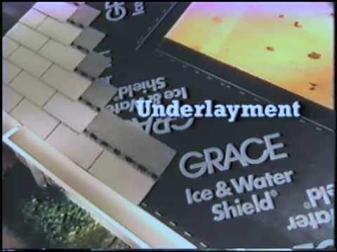

It would defeat the purpose of the “peel and stick” to put it on top of felt paper.
Since this is a tile roof, it appears they are going to use the peel and stick in the valleys and crickets, then hot mop 90 lb over it. The next step is to do a foam-down tile roof.

Evidently, a youtube video isn’t superceded by the manufacturer:
Polyglass

The YouTube video was put out by the manufacturer “Grace”.
Your link says Polystick membranes shall not be adhered directly over a pre-existing roof membrane as a recover system. Look under “General Limitations”, #5 of your link.
At any rate, up here, it would not be acceptable to apply “peel and stick” over felt paper.
We use “Grace” Ice and water shield up here, typically. And they say “Install Grace underlayments directly on a clean, dry, continuous structural deck”…it adheres to the wood and doesn’t blow away. http://www.na.graceconstruction.com/custom/underlayments/downloads/UL-061C.pdf
Exactly, ALWAYS on the Plywood-OSB, in AZ…!
