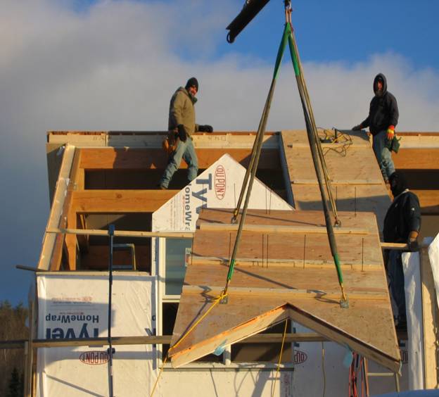

Some builders prebuild the roofing into sections or even the whole roofs including the shingling and then LIFT them onto the framing. Then remove the lifting eye. Others will leave the lifting eye attached. So if you see what looks like an circle on a bolt, (lifting eye) or a few dabs of roofing tar on the roof that is what it was for. They have to have pretty good bracing for that to attach to. Hence the welded nut, (lifting eye screws into that nut) is there.

The decking keeps the trusses from collapsing together, they attach a spreader bar for large lifts and just attach to the hook for small lifts, then bring down the slings/chokers and attach them to the lifting eyes that are secured by lifting support plates. At 2, 3 or 4 points on the roof.
The eyes are mathematically spaced to even the load out. That would be the En Ga Neers job, I’m only a licensed rigger, so I leave the lift points on something like this to the En Ga Neer. Odd shape, different angles and slopes and weights all over the place. They have to figure in the weights of different wood, nails, splice plates of the trusses, even the moisture content of the wood on large lifts and sometimes on the smaller ones for proper angles. Complicated to say the least.

Shell building instruction for lifting,
http://www.sipweb.com/Manual/placing_roof_panels.asp
First pic small lift,see the spreader bar in the top of the picture also. second picture… SMALL MULTI MAN LIFT,

The first pic looks like a SIP panel, which is easy to lift compared to a trussed roof.
It doesn’t look adjustable for width, so that center bolt looks like it’s there to anchor an eye-bolt. Sometimes they’ll build the whole roof on the ground where it’s easy, then have a crane lift it right up and set it on top of the house. Was this the only one or were there more? like… 3 more.
