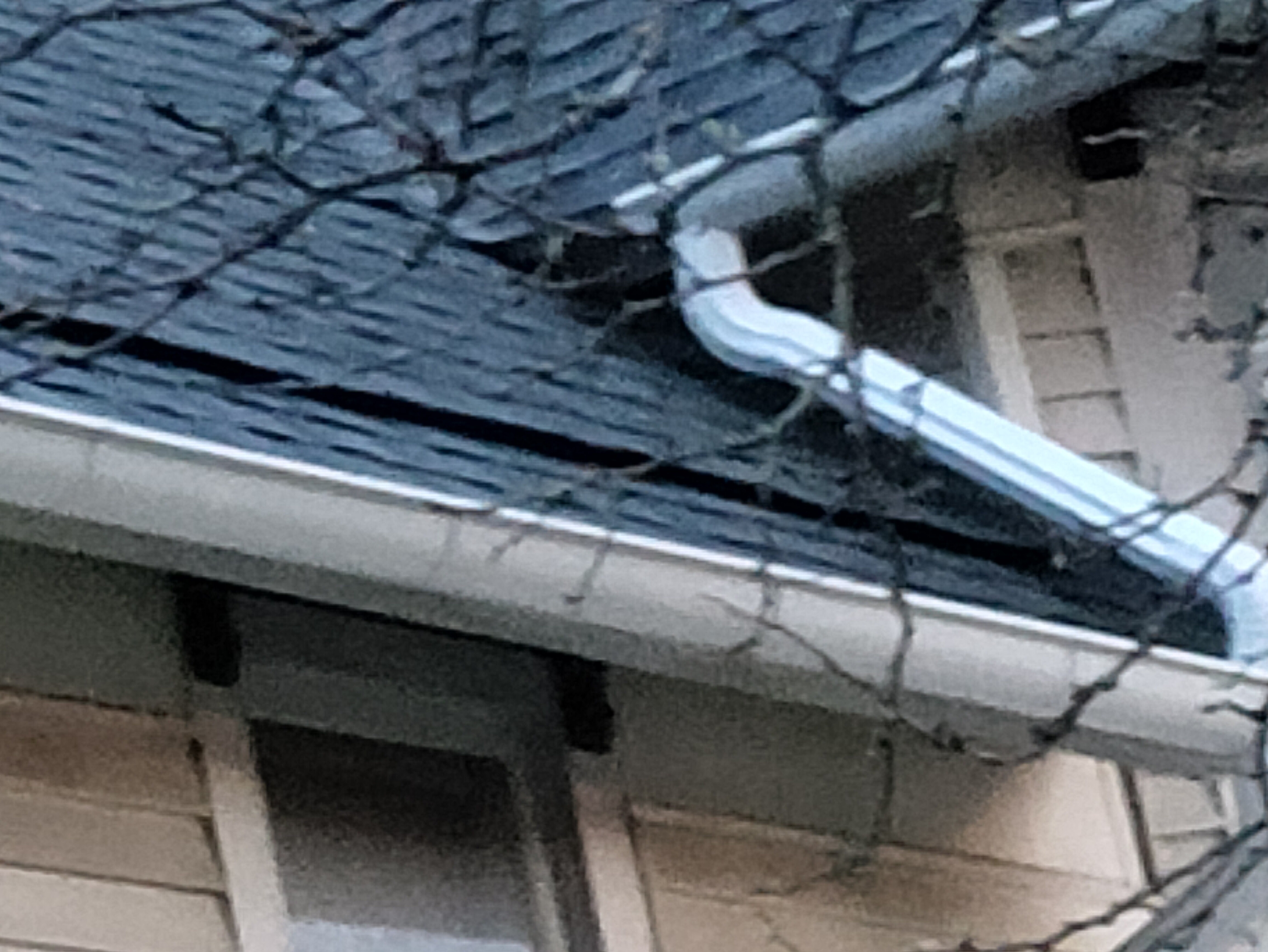

I was trying to start my own thread but couldn’t figure out how to do so I also have questions about roof vents on a house that I saw recently and took pictures of never seen vents installed a foot from the eve laterally like a ridge vent.
 ![IMG_20210429_204921](https://global.discourse-cdn.com/internachi/original/3X/6/2/629b05909083273a6cd6bfadc5bb48d2c43bb5dc.jpeg) ![IMG\_20210429\_204544|665x499](upload://rd3MGUaZ14yQHOIVDDRL5kWe8mC ![IMG_20210429_204550](https://global.discourse-cdn.com/internachi/original/3X/8/5/852bd89a43ec87f165f4fc5bddfe47a5529f4b28.jpeg) .jpeg)

I believe your are looking at a shingle over rooftop vent.
> **[IntakeVent\_SellSheet\_CTR20-20-3456\_LR\_2001\_E.pdf](https://www.certainteed.com/resources/IntakeVent_SellSheet_CTR20-20-3456_LR_2001_E.pdf)**
> 736.91 KB

It looks like David has it:
 ![0](https://global.discourse-cdn.com/internachi/original/3X/a/d/ada052813ef926eb4c349ad47f80004bfffb7ada.png)

I have only seen it once before and that was on a colonial style home with no soffits.
 ![P7290105](https://global.discourse-cdn.com/internachi/original/3X/a/6/a69fdfbc16b34e784a588a510c5f89f89e15db0e.jpeg)
