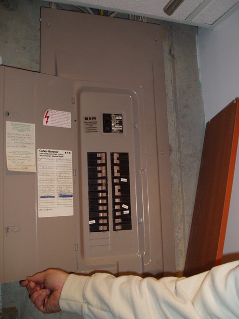

Has anyone came across this type of material for a roof? It appears to be tin or aluminum. I cannot imagine them using aluminum?

Did you intend to post a picture of a panel?
Also, carry a magnet in your bag. It helps in determining an answere to your question.
Jeff
Disregard electrical panel, cannot edit pictures to take out.

I know you said to ignore the panel pic but what is going on with how it is mounted and how the wires leave the panel?
