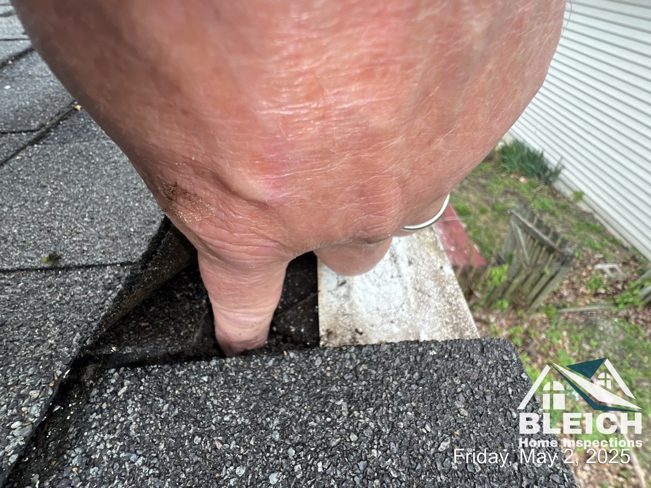

Definitely, don’t go ramming a screwdriver, ice pick, etc. into finished surfaces. Sellers get SUPER cranky. Once I see something I suspect, I usually just use a finger… VERY softly but it’s really just to confirm what my eyes have already told me. Don’t break the surface… just give it a little push and you can feel the lack of resistance.

If it is a finished painted surface such as window/door trim, I am not making any holes. The touch and go method is sufficient. Decks, floor structures, etc. I will do gentle probing with a tool in an inconspicuous location.

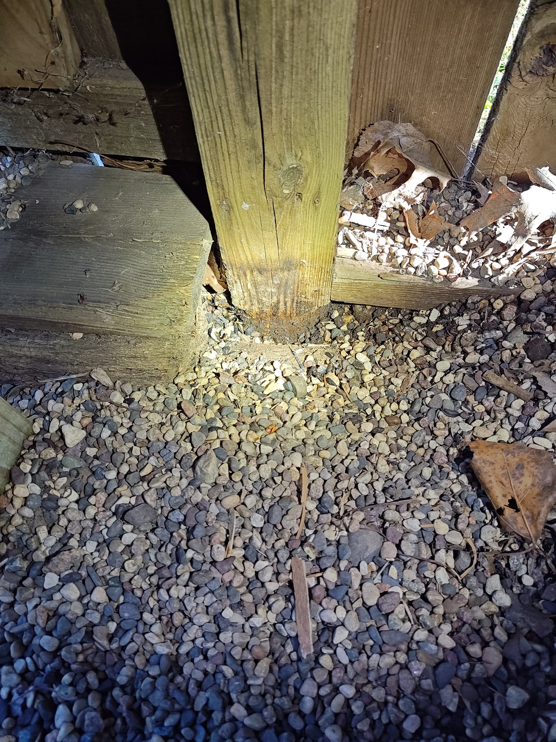

A big screwdriver doubles as a digging tool for around deck posts buried in soil and landscape rock, and as a probing tool to test those poles. The long screwdriver lets you test further down, without having to dig further down.
First I use my eyes, if I see suspected wood rot, I then use the tap test or push on it with a finger.
