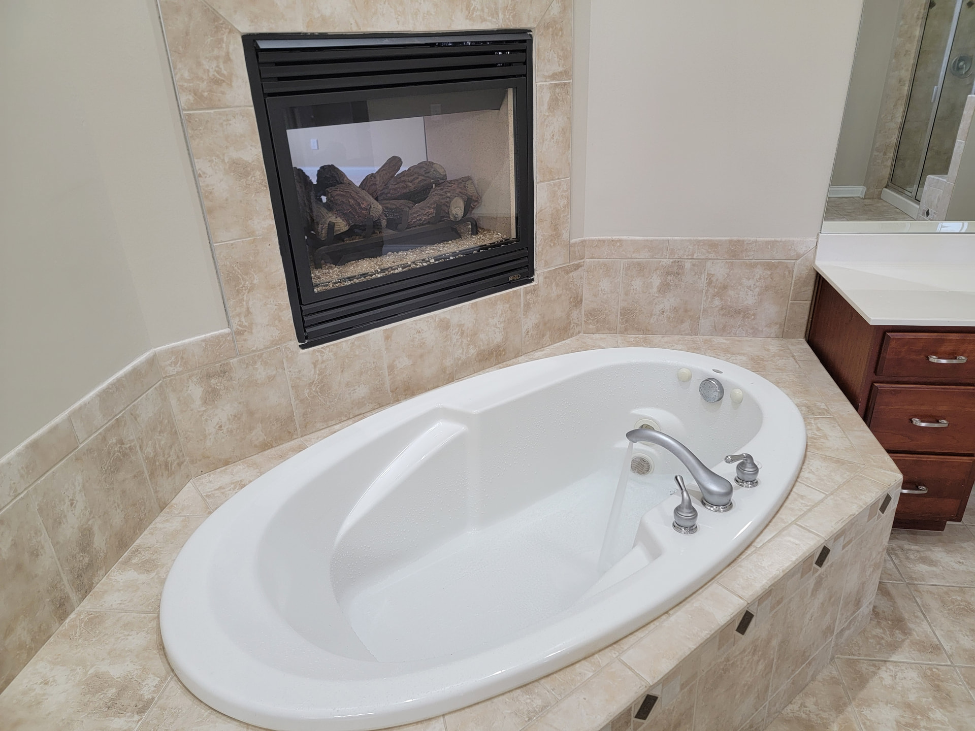

Home had a gas firplace in the primary bedroom that was also open to the primary bathroom directly over the bathtub. These gas fireplaces can get very hot and my concern is someone slipping in the bathtub and falling into or against it while in use.
I wrote it up as a potential safety hazard but wanted to post this question here to get other inspectors thoughts on this.
This is the first fireplace I’ve ever seen installed over a bathtub like this.
Frankly, they can slip and fall into the corner of the adjacent vanity top just as easily.
I wouldn’t write that safety concern up.

My concerns would be…Is it tempered glass; is blower receptacle GFCI protected; is the cabinet bonded to ground; does it receive combustion air from somewhere other than the bathroom; and what does the manufacturer says about it.
Edit:…and the mental state of the person who decided to put a fireplace above the tub.
Wow! + six
Yes, it is tempered, but these get so hot that if you touch the glass it will literally melt your skin to the glass.
Good point. No it wasn’t.
I don’t know for sure, but I doubt it.
Yes, it’s a sealed type of gas fireplace and recieves combustion air from the exterior.

Fire rated glass. Way more safe than standard glass breakage.
Burns are more likely, as well as accidents during manually controlled or resetting operatings on a uneven slippery surface with metal protrusions.
I would call it out for safety also, in the report… out of the report i would call it out for a dumb set up

The gas fire box is not directly over the bathtub.
You should avoid installing a gas fireplace beside a bathtub for various safety concerns.
Burns. Water splash directly on hot tempered tempered glass.
I listed several other issues above this post.
Screening on the glass has been required for the last 10 years and it doesn’t look like it has that.
That would probably be the extent of my narrative, “Use caution when operating the fireplace while in the tub, it gets hot”, or something to that effect.
House was built in 2005, so no screen, although they might be able to retrofit one if they wanted to.
You made the right call Kevin. I would have done the same.

G2406.2 (303.3) Prohibited Locations
Appliances shall not be located in sleeping rooms, bathrooms, toilet rooms, storage closets or surgical rooms, or in a space that opens only into such rooms or spaces, except where the installation complies with one of the following:
  1. The appliance is a direct-vent appliance installed in accordance with the conditions of the listing and the manufacturer’s instructions.
  2. Vented room heaters, wall furnaces, vented decorative appliances, vented gas fireplaces, vented gas fireplace heaters and decorative appliances for installation in vented solid fuel-burning fireplaces are installed in rooms that meet the required volume criteria of Section 2407.5.
  3. A single wall-mounted unvented room heater is installed in a bathroom and such unvented room heater is equipped as specified in Section 2445.6 and has an input rating not greater than 6,000 Btu/h (1.76 kW). The bathroom shall meet the required volume criteria of Section 2407.5.
  4. A single wall-mounted unvented room heater is installed in a bedroom and such unvented room heater is equipped as specified in Section G2445.6 and has an input rating not greater than 10,000 Btu/h (2.93 kW). The bedroom shall meet the required volume criteria of Section 2407.5.
  5. The appliance is installed in a room or space that opens only into a bedroom or bathroom, and such room or space is used for no other purpose and is provided with a solid weather-stripped door equipped with an approved self-closing device. Combustion air shall be taken directly from the outdoors in accordance with Section 2407.6.
  6. A clothes dryer is installed in a residential bathroom or toilet room having a permanent opening with an area of not less than 100 square inches (0.06 m2) that communicates with a space outside of a sleeping room, bathroom, toilet room or storage closet.
It is a direct vent gas appliance. Combustion air is not an issue. Yes, it will get hot and burn you if you touch the glass! It is basically a fancy space heater!
Yes, I would let my client know that they need to use caution with it and when taking a bath!
