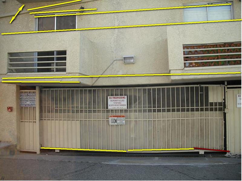

Sag at Opening
Walking in common areas…
That doesn’t look right :stuck_out_tongue: , was a bit “lumpy” on the interior as well.
Ya think balconies are supposed slope towards one another like that?
Thought I’d share.
Seeing as how the gate has the same sag I am guessing you are pulling a fast one on us.
Nope… if there’s a sag in the gate… it’s coincidental. Even if you allow for parallel sag, you can still see the reveal above the gate taper from outside to center. On the interior of the units, there’s about 3" of diff in height over a 15’ area…
The sliding glass doors seem to match the balcony’s slope. Does look off. I’m with Bob, optical illusion!!
Notice the top rails of the two balconies line up straight yet the second floor balcony on the left side section left in the picture is at an impossible angle.
What’s going on here ?
Yes I see the stucco patch in between going vertically.
The simple answer is (but doesn’t photo very well), when you’re looking out from the inside parking area (behind gate) there is a visible sag / dip at the opening, between the two balconies…
The interior floors were wavy as well…sumthin’s a movin.
Place has probably been stucco’d and re-stucco’d and as of recently…patched. Doors opened out of square… posted a pic of one of the interior doors.
Major and creepy structural issue.

While I wouldn’t call the first floor “soft”… the pile/pier type of construction for this commercial property lends itself to some specific concerns…
The other problem, of which you’re probably familiar, you find structural defects at a HOA/Condo property… they may not be in a hurry to get a SE over there… and less likely to comply in a contingency period. For us… that’s a little neither here nor there.
Observe and report.
I imagine you called for a structural Engineer on that one.
