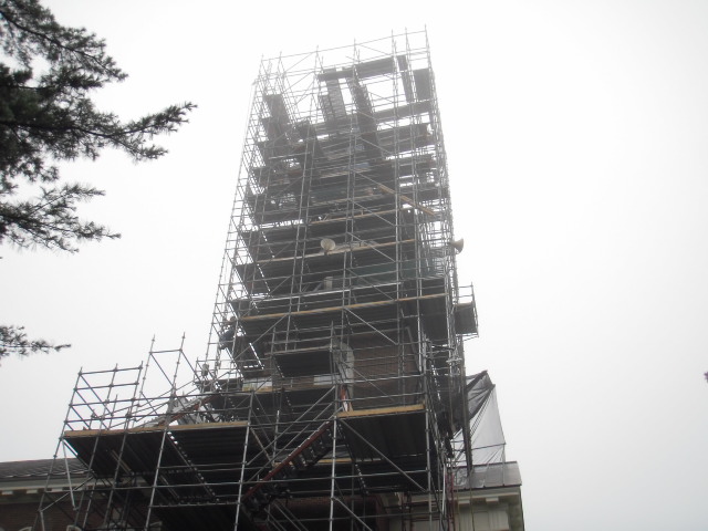

Since a lot of safety is involved in this topic and the picture shows a type of Commercial Staging Erection, I thought I could add a few pointers.
The employer shall have each employee who performs work while on a scaffold trained by a person qualified in the subject matter to recognize the hazards associated with the type of scaffold being used and to understand the procedures to control or minimize those hazards.
The employer shall have each employee who is involved in erect-inspecting a scaffold trained by a competent person to recognize any hazards associated with the work in question. The training shall include nature of hazards, correct procedures and design criteria of the intended load-carrying capacity and intended use of the scaffold.
If more than one level, a qualified person should inspect the staging prior to use by employees and a green tag inspection noted as such on each level for all to see, that it is at the moment in a safe condition.
Access ladders should be provided at all levels.
The employer should avail himself of the safety and heath training programs available to all employees.
Employees should be instructed in the recognition and avoidance of unsafe conditions and the regulations applicable to his work environment to control or eliminate any hazards or other exposure to illness or injury.
All scaffolds shall be erected under the supervision of a Qualified Person
Qualified Person =
Means one who, by possession of a recognized degrees, certificate, or professional standing, or who by extensive knowledge, training, and experience, has successfully demonstrated the ability to solve or resolve problems relating to the subject matter, the work, or the project.
Here are a few pictures of a staging that requires extreme safety.

One final question: Hypothetically, if a scaffold was erected, and railings were not completely installed, is it deemed safe?
No, a competent person should inspect all staging areas prior to use by personnel. Proper safety rails, toe boards, full planking, and any other areas that would pose a danger to any and all employees, need to be inspected prior to its use.
If railings are not complete or would pose a hazard to personnel, it should be red tagged Not Safe, Do not Use, until corrected.
A green tag, signed by the competent person should be placarded when safe to use by all personnel. :slight_smile:
