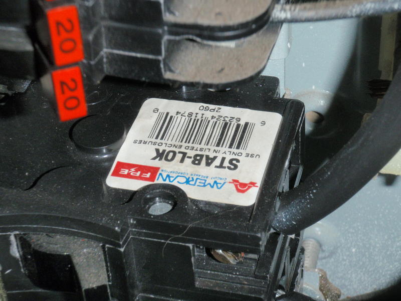

IMHO it is a FP Stab Lok. Does not need a thermal investigation to know that most of them have failed or WILL fail. Panel needs to be replaced. Best advice one could give their client about that panel.

David my primary city I inspect in has approximately 75% FP panels there is no requirement to replace we have two insurance companies here that will not insure a home with FP panels. I inspect the FP the same as I would any other panel. I just inform the client of the past history on these panels and my job is complete.
I have seen many FPE panels that appear fine and I have seen many with internal scorch marks, burn insulation, trip breakers, loose breakers and breakers that fall out and apart when you remove the dead front cover (I will no longer remove the dead front cover on them, business decision). As an inspector we can recommend replacement but we CANNOT make anyone replace them.
They are problematic panels and I recommend to all my clients that they be replaced. It may be working today yet new people in the building with new electrical demands and poof up pops a problem. Kind of like the Premier Furnaces are you willing to take that chance or let your client?

Stab-Lok panels have poor contact at the breaker-to-bus connection by design. These panels run hotter than other panels under a load. Every time the panel warms…metal objects expand. When the load reduces or ceases…metal objects cool. Add this to a 40+ year old stab-lok panel and things get loose. Electrical equipment doesn’t get better with age.
Over the life of the panel, this “heat cycling” leads to loosening of…well…everything in the panel…
The breaker “fingers” loosen at the bus and every mechanical metal connection experiences the same fate…loose equals hot…hot equals heat cycling…heat cycling equals loose. It has a snowball effect. From an IR standpoint, you can witness the same effect that would occur if you were to take a 3/0 gage wire and splice in a section of 8 gage…if you were to look at that splice with IR you would see the 8 gage wire glowing like a beacon (if it wouldn’t melt 1st). Poor contact effectually reduces amp capacity. When you reduce amp carrying capacity without reducing the amperage the circuit has to live with, the result is heat. Usually very focused/concentrated heat that needs to go somewhere, usually transferred through conduction to nearby components.
Essentially, poor contact due to loosening and/or oxidation (which usually accompanies loosening due to age) is very easily spotted in a thermograph and highlights the benefit of IR for electricity…
We’ve had the ability to to *quantitatively *evaluate electrical systems for decades with ammeters, voltmeters, and every other gadget. IR allows you to see things previously not possible. You have to be careful though…quantitative analysis of an electrical system cannot be accurately performed without 1st eliminating any heat associated with loose connectors, and that can’t be accomplished without referring it to an electrician. Given these facts, going much further than finding “hot” is dangerous and bordering on guesswork regardless of your certification level.
A correctly wired circuit will have a somewhat even temperature distribution with no apparent hot spots. Think about it…there’s nothing inside of a panel except mechanical contacts…they’re the only heat source and they act like a lightbulb if loose.
I don’t really have a source for this information, just common knowledge of what happens to a circuit when you throw contacts into the mix. In the case of Charlies defect…its not the 200+ degree heat that’s inherently dangerous, its the arcing, sparking, and melting that occurs when the contact degrades further, which can lead to momentary temperature spikes reaching the equivelant temperature of a welders electrode.

Here’s a stab-lok I inspected today. I come across a lot of these panels. This example is one of the more modern versions installed in a home built in 85. There were no problems with this panel but I will still recommend an upgrade.
