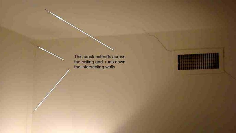

It’s Halloween, so I want to talk about things that can be scary: cracks. We all know that houses move and produce cracks, even new houses, but I want to talk about cracks that are scary. The cracks that you’re looking at in the first picture were produced by moisture from a deteriorated waste pipe that caused expansive soils beneath a slab-on-grade house to swell and move the house—one might even say, naturally. However, this movement could have been predicted on the outside by fissures in the soil, shown below, that are typical of expansive soil. The moral of the story is this, make sure that you’re knowledgeable about the soils in the areas that you inspect, and if you see any evidence of movement—even repaired stress fractures, recommend a second opinion. In addition, ALWAYS recommend that sewer pipes be video-scanned. Happy Halloween everyone.
Always do–always have. Several have been found to have become completely separated under the house structure or in a difficult area in the yard. Gives the buyer something to think about!!
