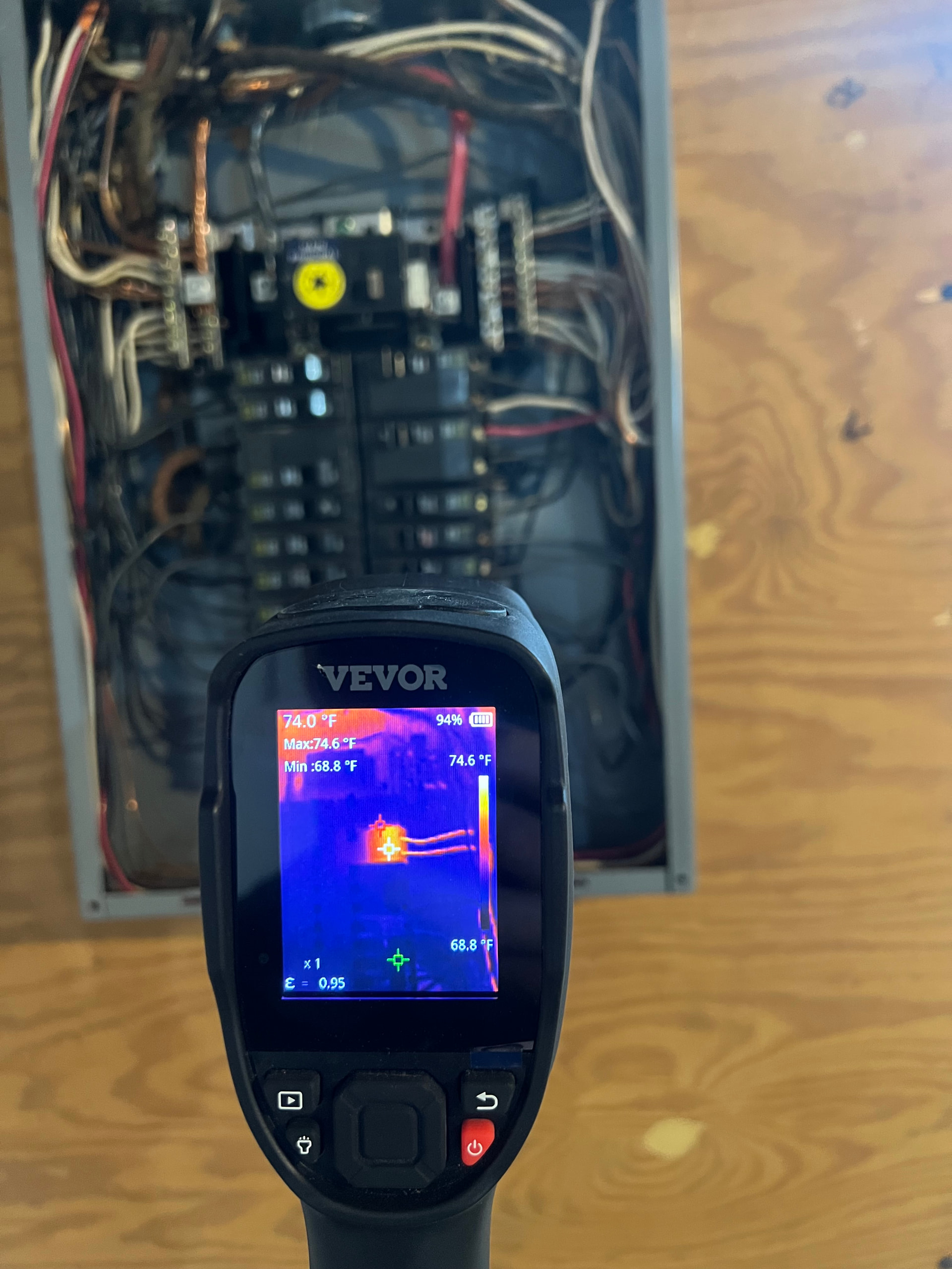

I found corrosion on the service conductor but no signs of moisture or no signs of overheating at time of practice inspection. Sure looks to me by the debris dust laying under the lug it has been doing this for a while. Any ideas why? The red sheathed cable looked good. I sent extra pictures to show the left side is not loaded any more then the red cable side

Thanks for asking that question, it practically told me I need to better or add to my photo takings. It drops in straight from the meter and conduits seemed ok, but I do not have a good picture as it enters the house (lesson learned). Then my stand back picture of the panel shows me it shoots straight up a maybe 16” and then swoops out. The infrared shot was the AC breaker. The house is vacant with AC running non stop, that thing never shut off, poor insulation in Attic.

The corrosion is caused by two dissimilar metals (copper and aluminum) bonded in an electrical circuit.
Why doesn’t it appear every time? Good question. I don’t know, but there is a preventative step of using an anti-corrosive paste seen often in electrical panels.
That’s a good find. Since corrosion does not conduct electricity they need to fix that…
Corrosion = resistance = heat = bad

some Of that “dust” is literally corrosion falling off from the lug due to exposure to moisture. The green patina on the conductors is from the copper, the white corrosion is from the aluminum lug, The brown outer section of the stain puddle on the breaker below indicates water. If it quacks like a duck, walks like a duck, and looks like a duck, it’s not a duck???
Also, don’t rule out water from the room above from a leak or spill
You need water for that. À la leakage, spillage, condensation. Otherwise, all these new homes being built with copper-clad aluminum wiring would have a problem.
Just report what you see and recommend a licensed electrical contractor to review and make all repairs as needed. No need to figure out the why’s or how to correct.

Looks like water got between the copper conductor and the insulation. Not that uncommon for water to enter the conductor in the meter enclosure. As mentioned just call out what you see. There are several issues in this panel so referring it to a sparky is warranted.
Don’t forget about deteriorated weatherhead seals. Once the moisture, (wind driven rain / snow / ice) make it past that, it’s straight down the conduit pipe and into the meter box!
