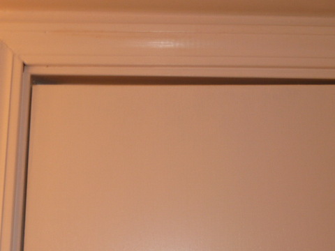

Inspected a 30 year town home yesterday and found the front storm door and especially a first floor bath door way out of plumb. There is also minor cracking extending outward from where a first floor load bearing wall meets the ceiling.
In the very yucky, uncondtioned crawl there were no visible signs of stem wall cracks in areas that did not have foam board insulation. There is an overspanning of the floor joists (24’’ o.c.) with a horizontal span of at least 14’ - No support beams OR bracing.
I suspect (so far) that the overspanning may be the cause of the cracks where wall meets ceilng. But what about the settlement issues with the doors. I’ve been unable to determine the likely culprit and would appreciate your feedback. Photos attached. I already know about the rot in the joist pic which is beneath the front door.

The first picture is telling me the the hinge side of the door has gone down a hair, or the latching side of the doorframe has gone up.
Unable to see if the position of the door is parallel with the framing member or perpendicular to it. If the door frame is parallel to the framing and is overspanned, this could happen. The sag in the framing would be enough to cause this.
The exterior screen door was not installed correctly.
This type of screen door comes with the hinge already on the door and the head piece trim and the latch piece trim come separate.
Typically, one would install the head piece trim and then hang the door and square it up with the head trim. The latch side trim goes on last and adjusted with the margine of the door.

Pic1 door is running perpendicular to the floor joists. I know about the sub-floor rot I just threw in a joist pic. You didn’t mention anything about lack of beams or bracing. Would this be a strong possibility?
Thanks Erol
Hi. Erol;
Yes.
Since I cannot see other than the pic’s, I would have to say that it is conceiveable to have that door movement due the overspan as you mentioned or something else to make the floor deflect in the general area of the door.

Yeah I’m one of those that’s needs to put the puzzle together. :wink: I’m almost positive the overspan without support beams is the culprit.

This is a judgment call, and you should describe what you’ve picture-documented and defer to a specialist. In the good old days before our industry became a fertile field for attorneys who were looking to “plough,” differential settling was anticipated and tolerated. It usually occurs in the first five to seven years, and one-inch in twenty feet was not considered alarming. Having said that, defer, defer, defer.
Defer is a good suggestion, but those floor trusses appear to be more than sufficient to span 14 feet without a center beam, and cross-bridging, if that’s what you meant by “bracing”, would not be required, so I doubt very much that the problem is with the trusses. It all depends where the doors in question are located, and the exact location and direction of the observed cracks. To make any kind of evaluation would require seeing the entire situation at once, thus: defer to someone who is licensed and qualified to do that.
