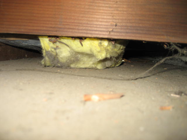

Gentlemen, Thanks for all the input. Overall, a very good discussion. One clarification to add is that the power vents were boxed in and exhausted the attic room through 2 6"X9" louvered grills. I believe the soffit, ridge and gable vents were pretty much their own system. Although there were no baffles in the rafters, the roof sheathing (1X10’s) were in good shape and I believe the air space in the rafters was clear. I removed a couple of soffit vents and peered down the inside and all looked okay. I was called in as a consultant on this one and my first thought was “Yeah, the rafters shouldn’t be insulated, heat buildup” but after seeing air space and feeling air movement decided “defective shingles”. If there had been less damage in some areas I may have gone with heat buildup, but the entire roof was disintegrated. Again, I appreciate all the input and look forward to more. I’ve learned alot. NACHI RULES, DUDES!!
Wally
ps. pix show sheathing condition (note ridge vent material on left), clear space between insulation and sheathing and (slightly obstucted) view down soffit.

If as Ed suggests the ventilation is at fault, and his theory seems like it holds some water to me anyway, a visual pattern of failure should exist. Even if the attic is not getting uniformly ventilated due to poor ventilation design, parts of it should be well ventilated and shingles above those areas should be in considerably better condition than those say, lower on the roof.
If the problem is defective shingles, the deterioration should exhibit more uniformity.
The problem could be a combination of both.
