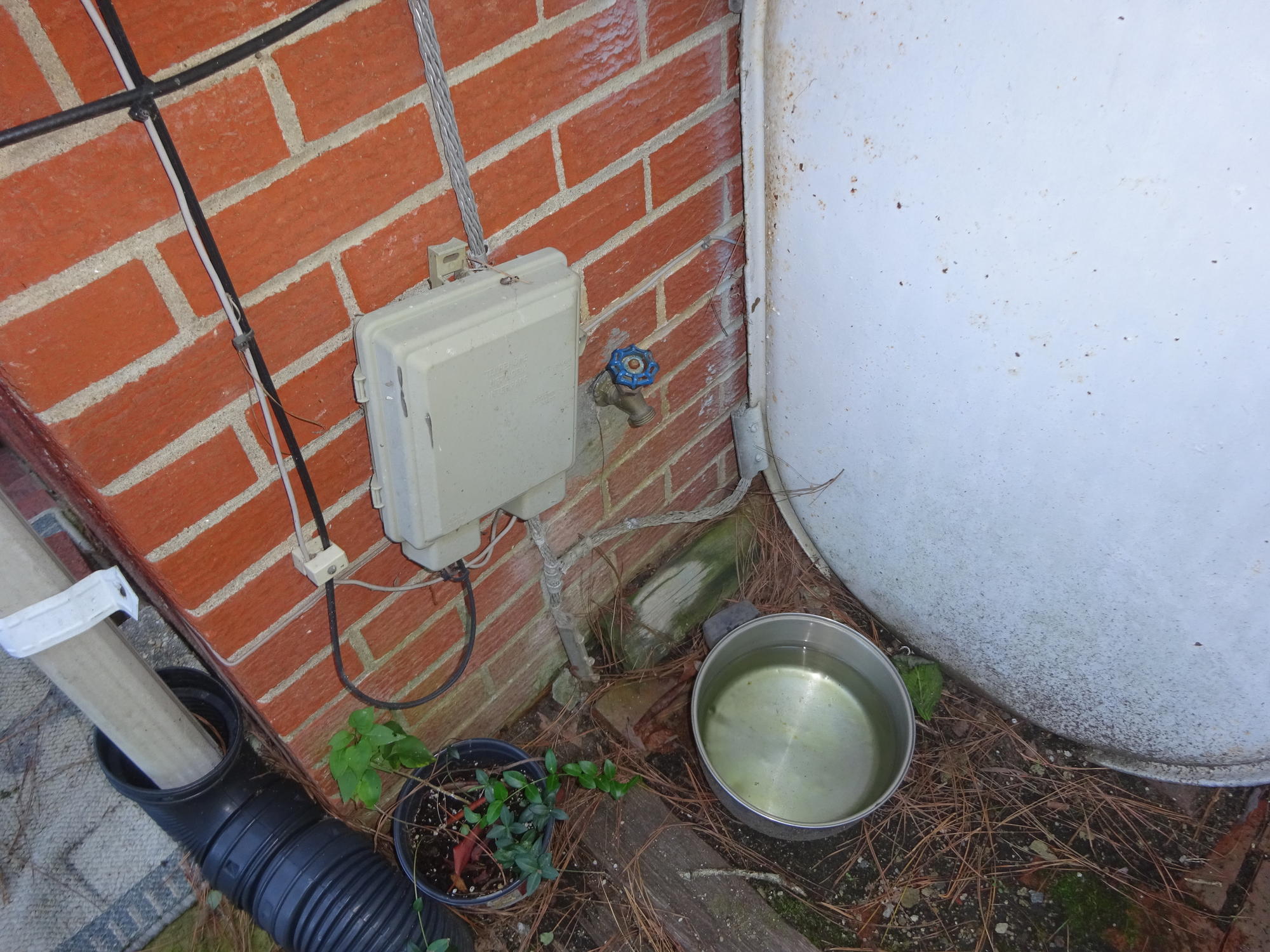

Question:
Should the lighting ground cable be bonded to the oil tank ?

Perry… I can’t give you an educated answer, but my ‘gut’ says it should be on a seperate ground rod. I understand why they interconnected it, but I would be concerned if it ever became energized when a lightning strike occurs.

My guess is that it’s not required to be bonded but it’s not prohibited either. You can peruse the lightning code (NFPA780) here for free:
http://www.nfpa.org/codes-and-standards/all-codes-and-standards/list-of-codes-and-standards/detail?code=780
23 years of servicing oil fire appliances never seen one grounded
Not many use oil around here, but never seen one bonded. Normally they are in the basement .
