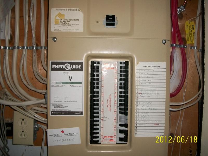

They still make and sell a Canadian FP panel in Canada .
Kevin says it is different then the USA FP panel.
I have never seen a USA FP panel .
I have a Canadian FP panel in my home and I am not changing it .
I am in the Process of putting in a stand by generator and have a Canadian approved FP Generator panel that I will be using .
They have Ark fault Breakers available for these panels available in Canada .

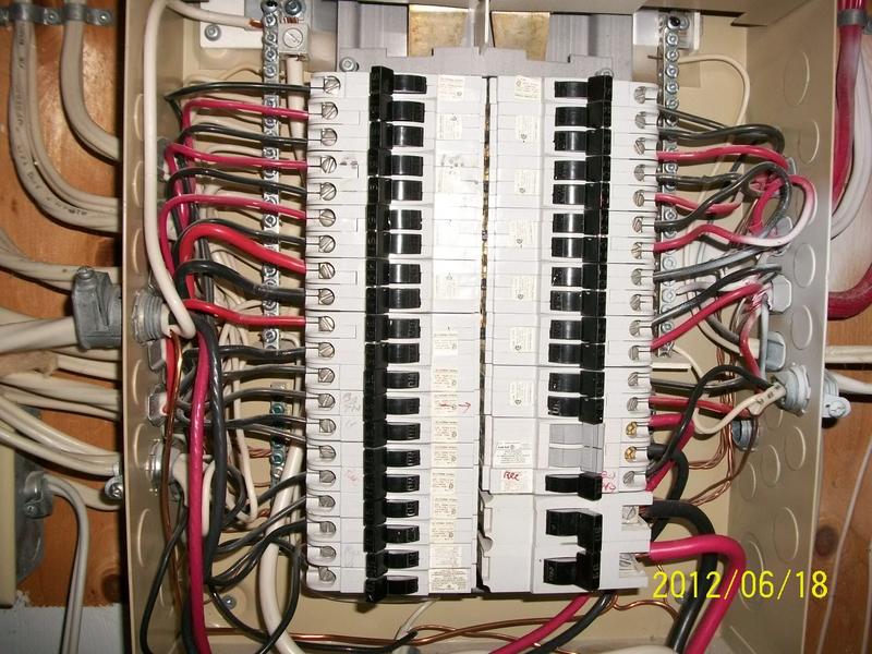

When you find time post a picture of it.
Here you are .

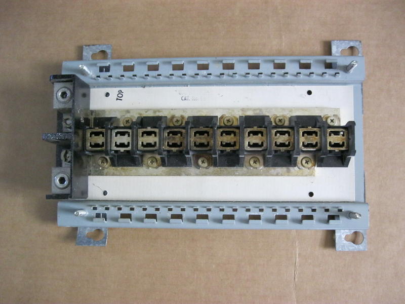

The Stab-lok bus bar design is one of the “major flaws” of these panels, and the Canadian panels are no different in this respect.
Actually I did do my research and they are different? I can’t dig everything up even though I am super human. LOL
Was that a question?
I can assure you, the bus bars are identical. It’s a key-hole punched plate that the breakers “stab” into, hence the name Stab-lok.
The only real difference with the Canadian models, are that the breakers are manufactured by a different company than the US brand.

Really Kevin? That’s all you’ve got? At least put up a fight - show me what a Canadian FPE bus bar looks like.

I do notice what appears to be a significant difference in busbar design from the American panel busbars shown on your website: Principally, at least with this particular panel, the busbars are each one single piece of stamped and folded brass/copper. There are no screw connections, other then the main lugs which appear to be held to the main busbar by a #10 screw (where the American counterparts where the connection was with a #8 screw.) They apper to have been stamped flat, and then have had the stab tabs bent over from alternating sides of the central insulator.
This might perhaps explain the fewer reports of bus failures in Canadian panels. Given the reports (albeit few) of breakers failing to open which have received CSA approval in older FPE and FP panels, I am inclined to not have faith in their designs, in spite of the potential for different manufacturing tolerances to favourably influence trip behaviour. Locally, Stab lok breakers made by Schneider electric, which are compatible with stab lok panels are available, and are actually fairly reasonably priced (between $10 and $40 CDN for 15A single pole >40 amp double pole.) Having not actually removed one of the older breakers (yet) I am unaware if the stabs on the breakers have been redesigned in Schneider’s products to improve their holding ability, which is my only remaining reservation on replacing the breakers in the panel.
