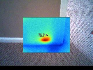

This is an interior wall, no heating or cooling ducts in this cavity, no electricity or plumbing in this stud cavity either. The photos are the front and opposite side of the wall.
So what can it be? I’ll see who answers first, and yes I do know what the issue is and will post later.
Nest?..Rodent?
Is it a bolt or fastener of some type?
More in info would help. slab floor ? 1 or 2 floor ?
The IR is blocking the spot in ?.
It may be a metal wall plate strap.
Best
Ron
Slab floor, below grade and no signs of moisture or any damage to the surface. It looked as clean as the rest of the wall.
I don’t known your codes in Atlanta re: interior walls
Its not termites or a pest problem. Each wall has the same issue in the same spot. That makes me think its part of the walls construction.

Here is what the problem was - Infrared pictures from Atlanta

After scanning this entire space of living area and did not notice any other possible deficiencies, I narrowed it down to this one particular spot.

This location was a finished walk-out basement. The ceiling was a dropped(framed) ceiling. From the garage side there were several openings for plumbing, HVAC ducts, etc… The buggers were getting in around the lines from the compressor, then up into the cavity with the dropped ceiling. I couldn’t directly see the top plate at this location, so I’m assuming there was a void big enough for them to drop down into the stud cavity.
I’m assuming they were actually stuck in there. As I was getting them out, they really wouldn’t climb up the inside of the cavity.
The target doesn’t appear to be on the hottest area of the image.

The temperature you are seeing is the temperature of the wall surface, not the squirel’s body heat.
The squirrel’s body temperature is conducting through the wall surface.
O.K. I understand now, thanks David.
Check up on direct/indirect scans.
Low apparent temperatures CAN be significant when they are indirect readings. A 4 degree delta from ambient can be a catastrophic event in some applications.
