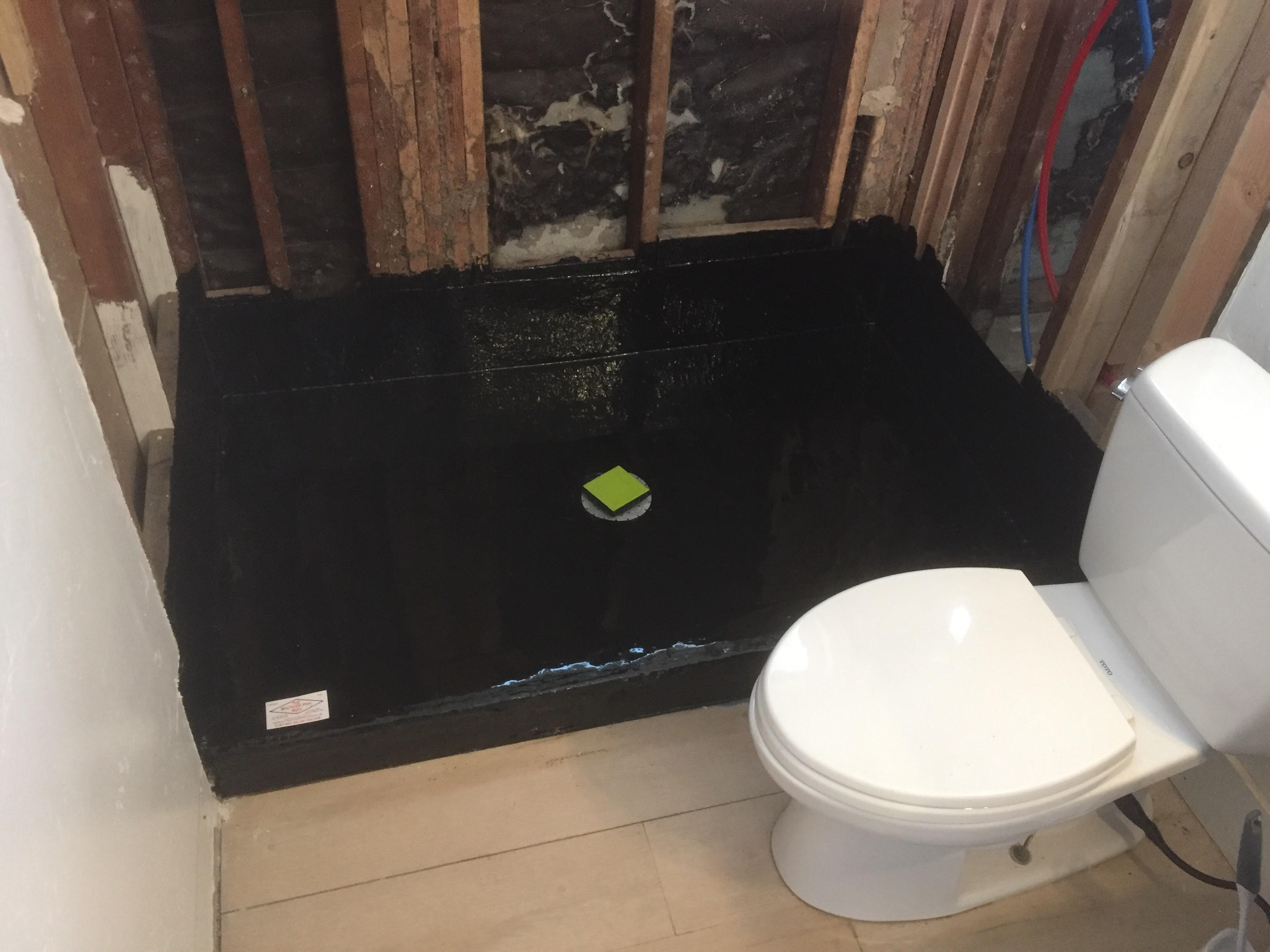

Is there a way tool to detect if moisture is being trapped underneath the pebble tile floor of a shower floor? No standing water, but it simply takes days for the grout to return to the same color as the other areas that seem to be drying faster. New shower pan, new hot mop, cement and pebble tile.

  • After two days it still looks like is has not dried completely. When knocking on the darker area, it sounds hollow and the dry areas sound solid.
Step 1. Hot Mop: The company, “Shower Pan Man” from Vista, Ca., used tar roof shingles to create the slope (stair stepping them down to the drain from all four sides). Then they did the hot mop.
Step 2. Different team for the floor tiles. They did the cement, tile and grout.* Grout provided by contractor

Team1. Hot Mop team: The company, “Shower Pan Man” from Vista, Ca., used tar roof shingles to create the slope (stair stepping them down to the drain from all four sides). Then they did the hot mop.
Team2. Installers for the cement, tile and grout.

Hot mop shower pan is done using melted roofing tar and felt, not roofing shingles. But it is an old school way of doing it before liners became available and products like Red Guard. Some still swear by the method, but how many new kids can handle hot tar? You kidding? :laughing:
They use composition shingles first for slope then tar, then felt. 5 layers of tar, 3 layers of felt paper, 15 lbs. felt.

That’s a great response. Thank you, Dustin. The tile guy thinks it needed another seal on it. We put a high pressure fan on the areas today, and it has slowly dried out to the color came almost to the other areas that were the proper color. He rolled on a coat of CUSTOM sealer, and said wait a day.
