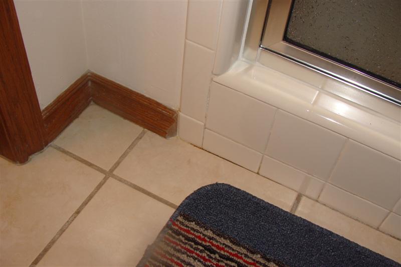

This one yesterday had me scratching my head. I had no visible water on the tile floor but when I scan the area near the end of the wood trim board there was a temp difference. The vertical grout joint at the shower corner and the horizontal joint at the floor where the brown or dirty grout was both soft and mushy and tested positive for moisture with the meter. The probes on the meter went right through the grout with out any pressure from me. I would not have seen this without the IR camera. I thought about this long and hard before I made the call. I did not know the time frame on the last time this shower had been used. The house was occupied I scanned the towel that was hanging on the rack and it had a good Delta T from being used but did not feel wet to the touch. We will see where this one goes.

Charley,
It appears that the shower door is not being closed fully.

DV Yes there was a problem with the door someone had tried to caulk the metal door frame but the moisture was under the tile not on the surface.

There could be a metal corner bead and or a wire mesh under the tile which the meter’s probes touched, thus the high reading.
