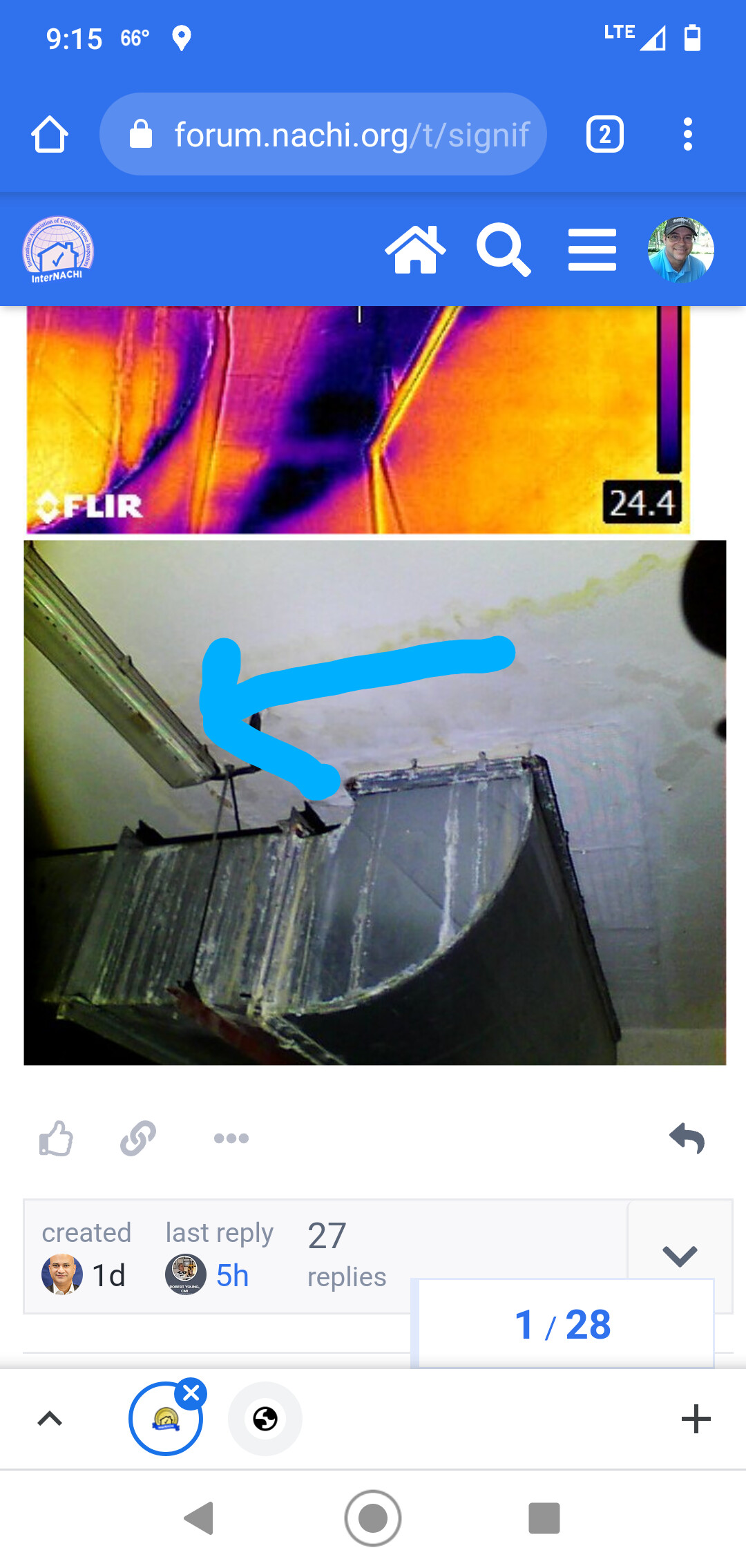

Significant water intrusion that is a bit mysterious

Is that a light fixture and is there water in it?
Could still be condensation
Intensity of condensation can be surprising don’t dismiss it.
Hi, Brian. Not sure which part are you referring to as light fixture? The leak is happening from the concrete Slab near an exhaust duct penetration into the slab
You require a plumbing engineering firm suited to track water sources.
Different color non toxic dies can be used to trace the water source, be it potable, waste or sanitary. A pipe may require replacing.

Light fixture?
:thinking: I don’t think it is a light fixture but will re-check during next visit
I have few thoughts not to discount HVAC. 1. Filled the pool and leak started. I would probably begin there. 2. If this celling is below grade, you need some plans to see what is running thru the ceiling, i.e. pipe, conduit, rebar. If the exterior concrete sidewall has any penetrations it could be the source. 3. Water test if possible. Pool water will be different from AC condensation and ground water. Best of luck.

Having inspected 142 New York City high schools, I would like to suggest the obvious: urine from a disgruntled occupant.
Wouldn’t one smell that, Darren, as regular as it seems to be?
