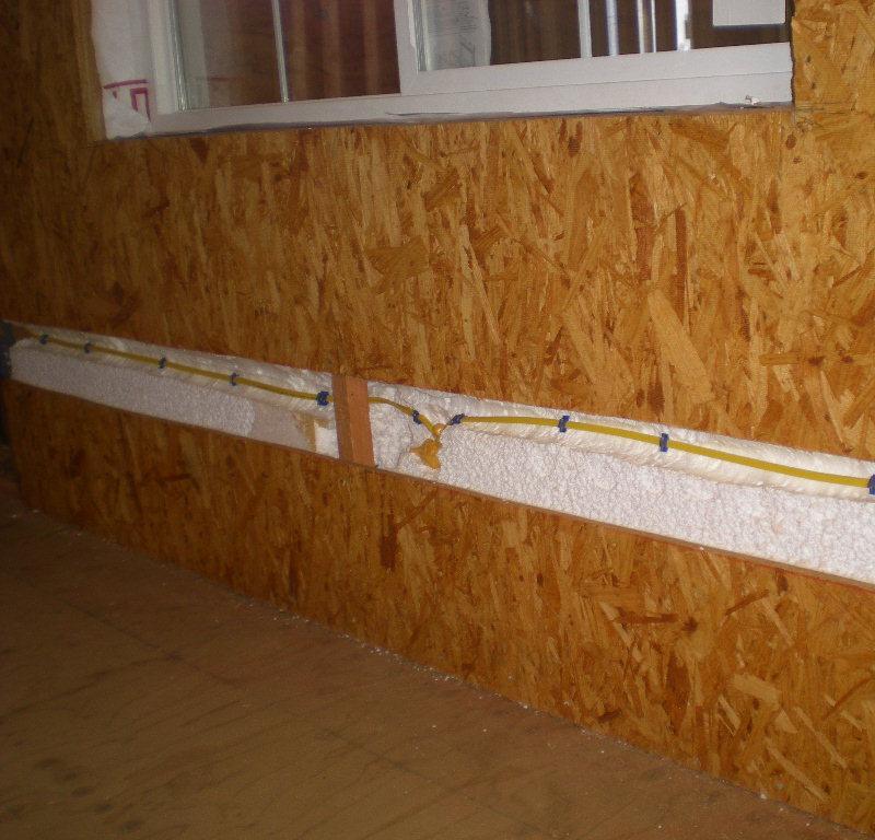

I need some info regarding the fischersips insulated structural panels. The panels come with electrical chases but the electrian cutout huge lengths along the chases. In some cases across the entire panel. I looked at the fischersips site but they had no install guides. Any help would be greatly appreciated.
Had similar problems with inexperienced trades and project management on the one project I was involved with.
Manufacture in this case allowed reinsertion of the wire chase cut outs and reskin/overlay with solid OSB glued and mechanically fastened to the original compromised material. You only loose a 7/16" of room space on the entire project doing this. I’d advise an engineer letter of approval as we obtained to ensure integrity.
