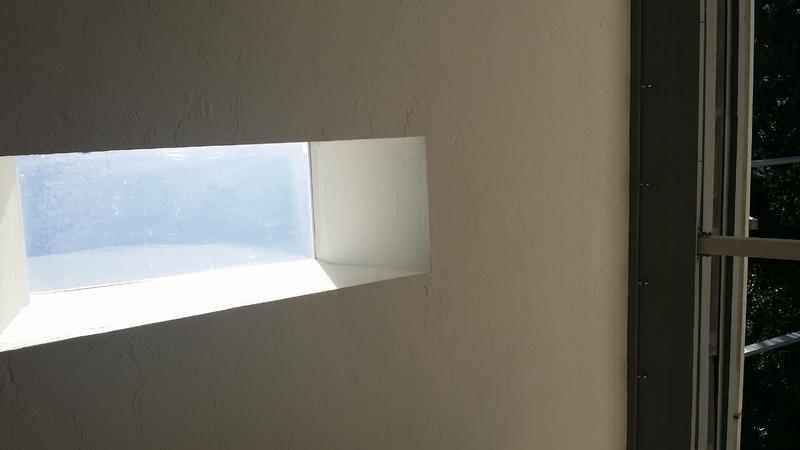

Skylights over unairconditioned space
Are unairconditioned lanai skylights relevant to a wind mitigation?
Not air conditioned or not enclosed? If its not enclosed then we don’t count it. Enclosed but not conditioned we count it
I have seen the same thing but client had no protection so it did not matter. My question is what about when it fails or gets damaged or blown away busted etc… what about all the damage that will result in the roof, attic system? Never seen that covered in a ny course and it is a Glazed opening that penetrated vital parts of the house. I am not so sure it should not be counted as unprotected if it is not no matter here it goes to.
Not counted for wind mitigation
I always counted them since it would open up the roof to the rest of the house that is over the a/c space; but I’ve never seen it written anywhere.
That’s a good question for the OIR committee :neutral::neutral:

I gave you the correct answer.
John answered the question. Even with a light shaft through the attic space, it still doesn’t count. If it did, we would have to protect vented soffits and gable vents, which are openings to the attic space.
I would think a gable vent on the side of a wall with louvers and a soffit vent underneath a soffit would be a great deal different than a gaping hole in ones roof. Does no one else see that difference. Both other items mentioned are designed to be open and let air flow through a skylight is NOT.
Okay, thanks John. Well, the window company sold them impact grade skylights none-the-less.
That makes sense.
Re-roof permits require impact and new construction requires it also.
Is that state wide? Or depends on you AHJ. The wind mitigation I did yesterday had a brand new roof but the original 1981 skylight.
That’s where it gets tricky. If in a WBDR, it is usually required to upgrade the skylight, however, some areas allow the 25% rule to be used for replacements. In other words, if the permit does not specify, you must verify…:frowning:
