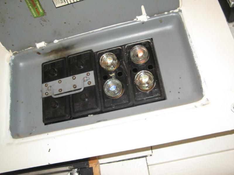

This panel surprised me. The panel was unlabeled but it was feeding the entire house and garage. As far as I can tell, one of the pull-out fuses boxes to the left fed the separate disconnect for the garage (also shown). The other one powered the range and dryer (double-tapped). That leaves the 4 fuses on the right to power all the receptacles and lights in the home. The entire home was wired with aluminum conductors except for 2 double-tapped copper conductors used for an addition. I asked the home owner if he ever has trouble with blowing fuses. He says he does, but he just has a stash of fuses handy just in case. At least he didn’t put pennies behind the fuses! :shock:

I think I see green in some fuses which would, typically, indicate over-fusing.
Wayne, there was no knob and tube left. At least that’s been upgraded.
Larry, There are so many problems, I didn’t mention them all. You probably noticed the burn marks on the panel as well. If that’s not an indication of faulty aluminum wiring I don’t know what is. Let’s just say I recommended a qualified electrician upgrade the entire electrical system. I’m surprised the house didn’t burn down.

Jeffrey, you’ve got me beat! I can’t believe that wouldn’t blow out fuses every day!!
It was not my inspection, but Casey’s. He is a Nachi member about 60 miles East of me. We talk and compare notes often. He sent me the pic with a few others we discussed.

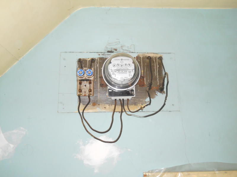

Here is one of mine from about a month ago…
1940 5-Plex…
SE… meters… disconnets… splice box… 35 Amp panels in each unit!
Of course each had a microwave, computer, window a/c, and whatever else they could plug in (with adapters, sometimes doubled up) !!!
