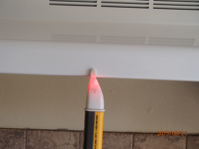

Equipment grounding conductor for the range hood was attached to the ungrounded conductor of the circuit :roll:
![20150821_17.JPG](https://global.discourse-cdn.com/internachi/original/3X/3/9/39d8015580deb9b6364ec0d9d14ba319bd7af6a1.jpeg)
![20150821_18.JPG](https://global.discourse-cdn.com/internachi/original/3X/4/d/4d334da7643a49446ada56e70ca492e85319dccb.jpeg)
![20150821_19.JPG](https://global.discourse-cdn.com/internachi/original/3X/2/c/2cb16cc4ca782d03a6ddda99fdd1c7b69631fccc.jpeg)

Where did the black conductor go. I see a green and a white. 🙂

Obviously it is not short, his ticker is picking up voltage.
Wonder what the black wire was hooked on too? 🙂

Black from circuit is connected to green, white from circuit is connected to white w/black stripe. I didn’t look to find where the other conductors from the appliance were.

Yes, the hood worked. Other than the electrical connection, it was a good installation 🙂

The hot went to the egc, and the neutral went to neutral. How was the motor or light getting energized?

If the unit worked then the green conductor must have connected to the hot conductor on the unit.
