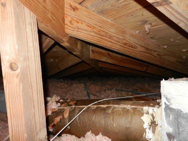

**Author:** ![mmeeker](https://sea2.discourse-cdn.com/internachi/user_avatar/forum.nachi.org/mmeeker/32/59432_2.png) [@mmeeker](https://forum.nachi.org/u/mmeeker)\
**Post date:** [January 5, 2012, 9:28pm UTC](https://forum.nachi.org/t/sop/65583/12 "2012-01-05T21:28:50Z")
</div>
I am there to verify “their” information.
Hence the name of the report “Uniform Mitigation Verification Report”
It is the clients responsibility to have all the information they need to prove their case. Just like they do with the NOA’s and such.
I will continue doing them as long as I see fit and will continue to do them the way I decide is appropriate. Just wait and see how much fun it will be with the new form. Are you going to spend a half a day on the phone with the bldg dept trying to get all the info the homeowner should have?
Yeah I am sure you will tell me you will do whatever it takes to give your client the report they deserve by choosing you. Don’t forget to crawl real close to get the pictures in areas like the ones attached. I and by the way I really could not give a rats a s s how you feel about how I run my business. You worry about you and I’ll worry about me 🙂
![DSCN3471.JPG](https://global.discourse-cdn.com/internachi/original/3X/7/2/7270a9c9ff45e6eef192617daa5fdc64483c7e84.jpeg)
![DSCN3467.JPG](https://global.discourse-cdn.com/internachi/original/3X/5/e/5e69aee85526564ae376547314075595879395b7.jpeg)
