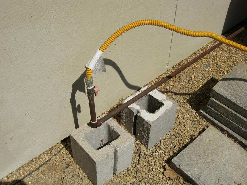

Here is good example from today’s inspection:
The home doesn’t have gas; however, there is a gas line going into the home near the heater. The heater is electric. The other end of the gas pipe wasn’t in the HVAC closet. I looked around for a some other gas-using appliance to no avail.
The whole thing is loose (just sitting on the block) and I’m not sure a connector is listed for exterior use. I read the tag and it did not preclude exterior use.
So, per the SoP, I inspect this under the “Plumbing” section as a gas distribution system and yet it is also “Optional” and could be considered a non-functioning gas supply system.
