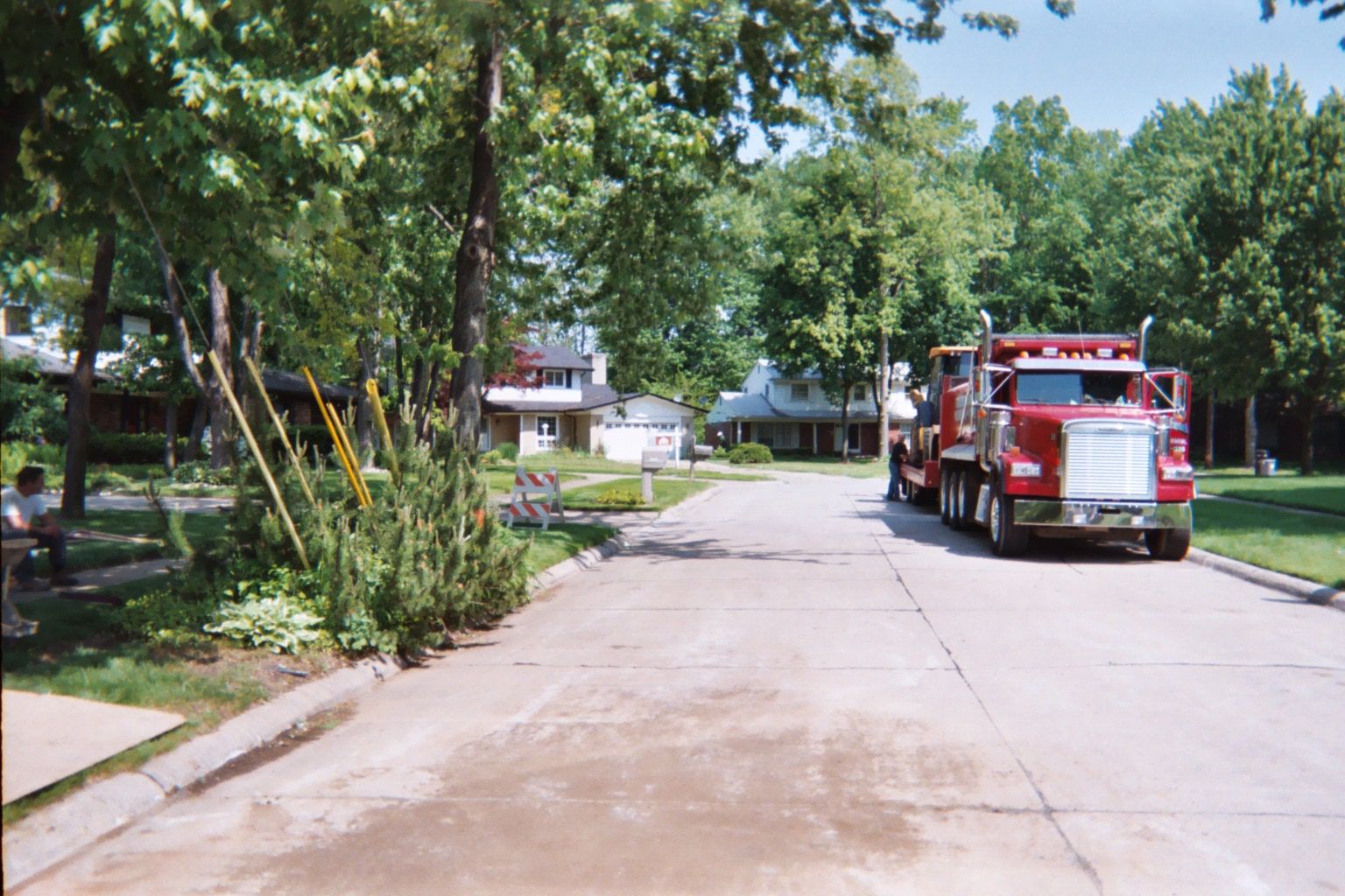

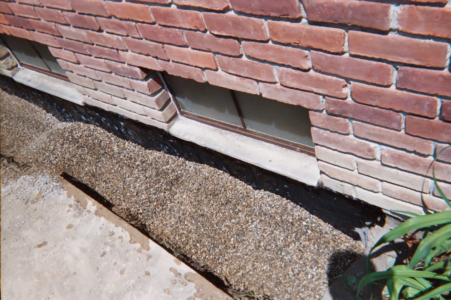

SOUTHFIELD MI, homeowners got several est's all except one, us lol, wanted to install an INT drainage system
… that would have cost much more money $$$, got that part?
they ONLY leaked in this area, so why talk them into anything other than what was needed and, the INT system would NOT have STOPPED the water from entering
lol oh shtt sorry clicked wrong button… rest of photos
yeah IN crack
another vertical crack, gotta get/seal that basement window too

Way to go, Mark, the way it should be done to stop water from entering the basement! :smile:
that was some crack partner…nice work as always…
Look how professional Mark’s site is…no beer cans here: :cowboy_hat_face: :grin: :rofl:
and plenty of lawn protection…I’ll be He’s done that more that once…

lawn protection? yeah lol, this is how it looks when we’re done.

Robert, yes sir free est’s and i bring my state lic and insurance on every est, no games no bull, whatever the problems are then that’s what lol the problems are and imo have ONE fix, if one of the problems is water entering through bsmt windows then those need to be repaired/replaced, if it’s tuckpointing (chimney etc) then that is the repair for that, if its exterior cracks in block walls then ext-waterproofing is needed to stop the water, if they have a blockage etc in their L-line/clean out then they’ll need an honest plumber, Mark Anderson basement waterproofing 586 777 7973 thank you Robert
oh lol and Robert, so you know, sometimes… if i can’t SEE what i need to see to determine the one or more problems i will explain then ask homeowner that imo it’s best for all if i run a water test with a hose in one or more areas to correctly identify their problem (s) to… get-to, the solution. Seems there are a few who either don’t ‘get’ this or just don’t wanna wait etc. I won’t do water test in this weather, like today, tomorrow type crap, just so you know.
