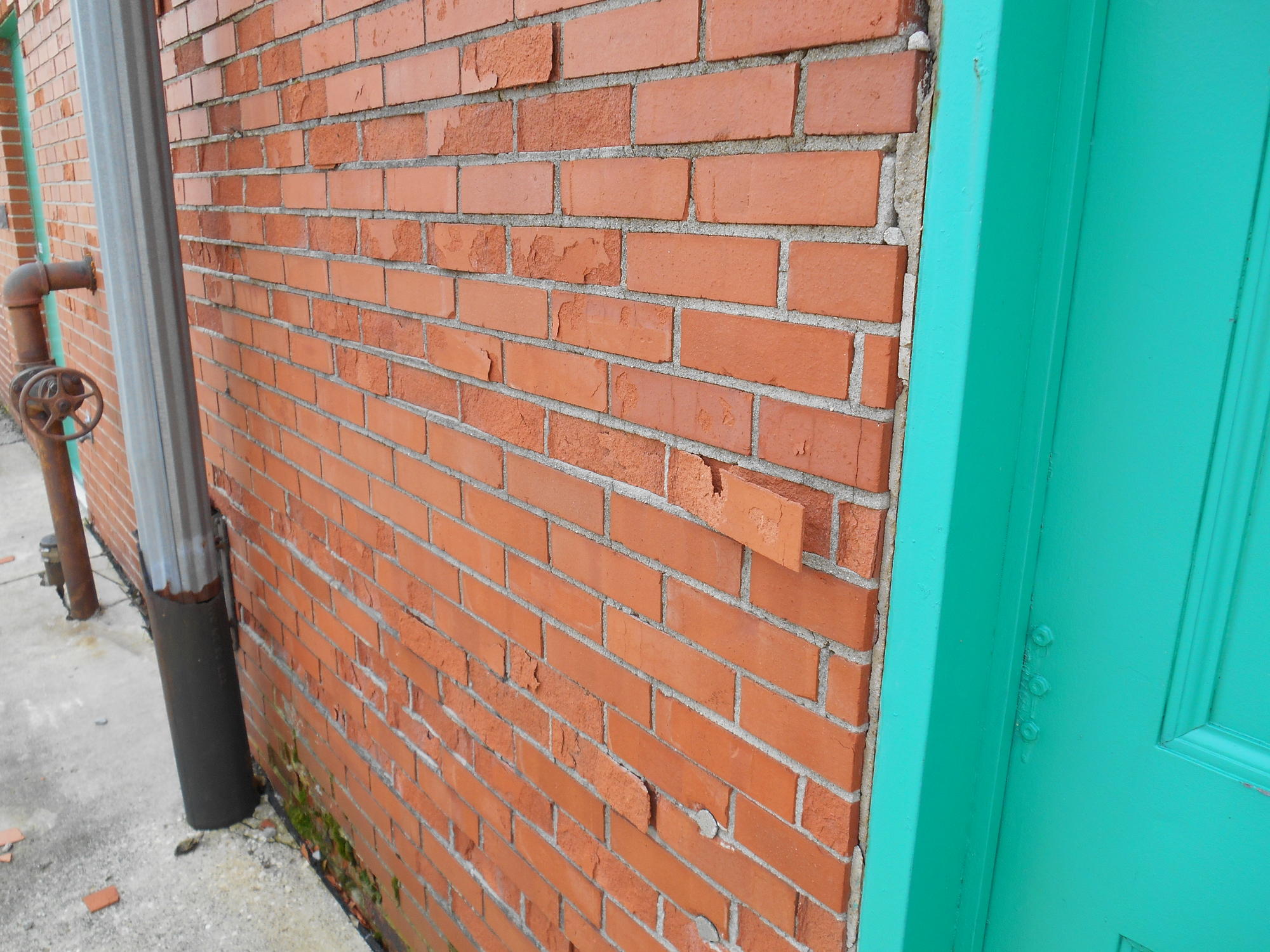

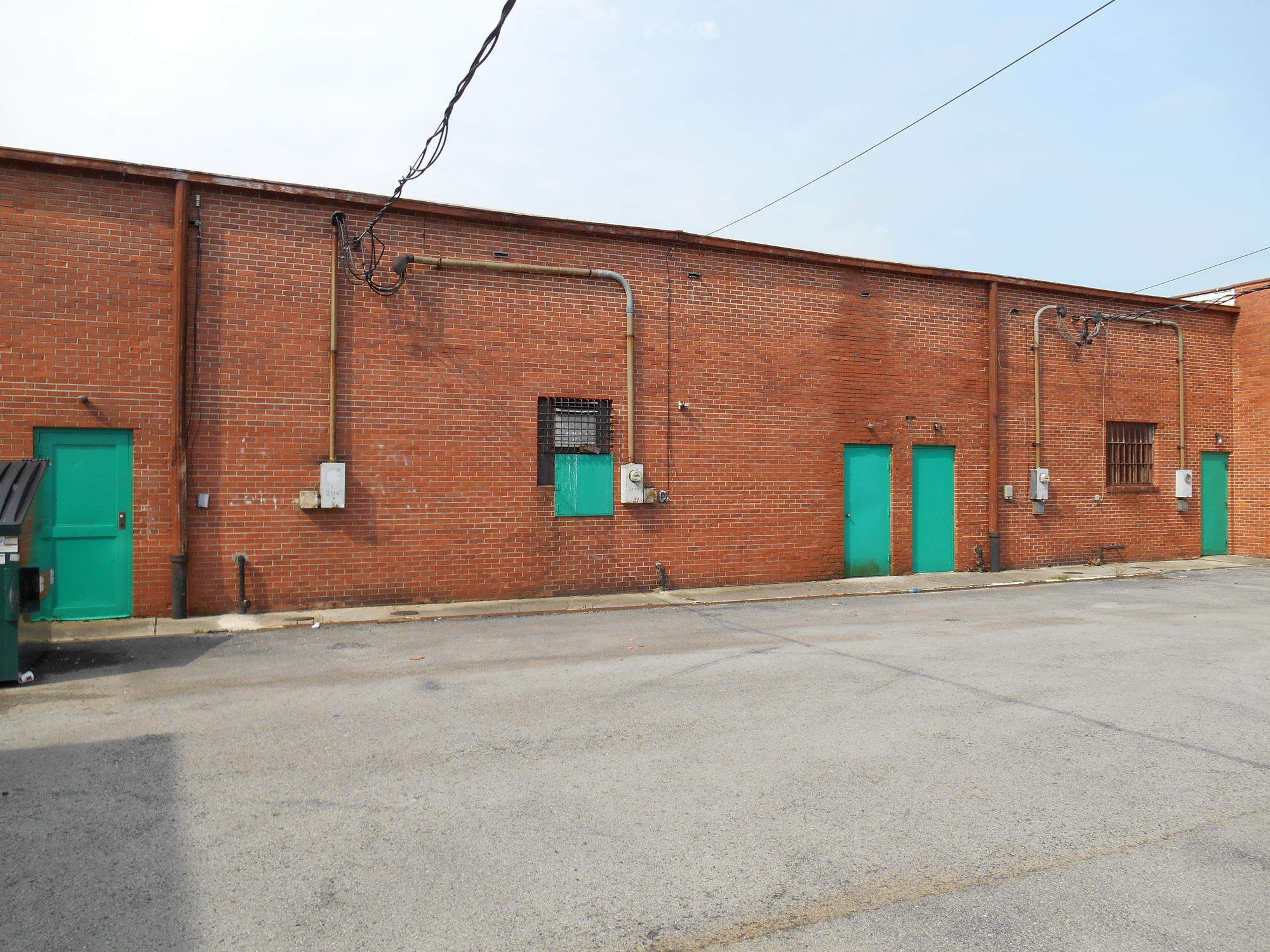

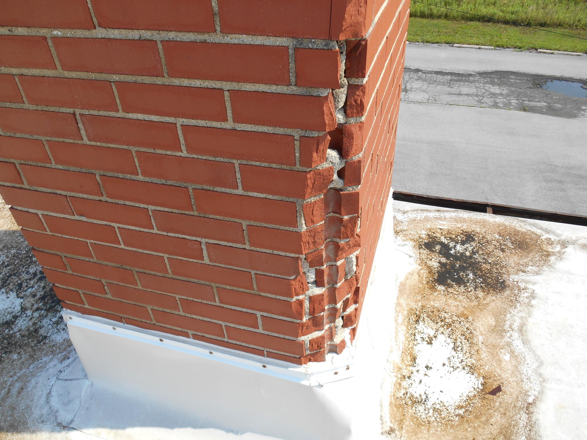

Kinda reminds me of some conditions I observed a few years back on a high rise apartment building’s exterior wall in minnesota near the top 100 feet up and also a few years after on a commercial shopping center in south carolina exterior wall + conditions on chimney
 ![DSCN0514.jpg](https://global.discourse-cdn.com/internachi/original/3X/1/4/14166e6d0bf0d60a93501bb1c8af751e0a6fa3ac.jpeg)
 ![DSCN0781.jpg](https://global.discourse-cdn.com/internachi/original/3X/1/9/1967b02720a3d95f1b78b8858d1a490f7b10ae3d.jpeg)
 ![DSCN0624.jpg](https://global.discourse-cdn.com/internachi/original/3X/d/6/d65421677475eb9e3382b1bb95846fc6d974c260.jpeg)
