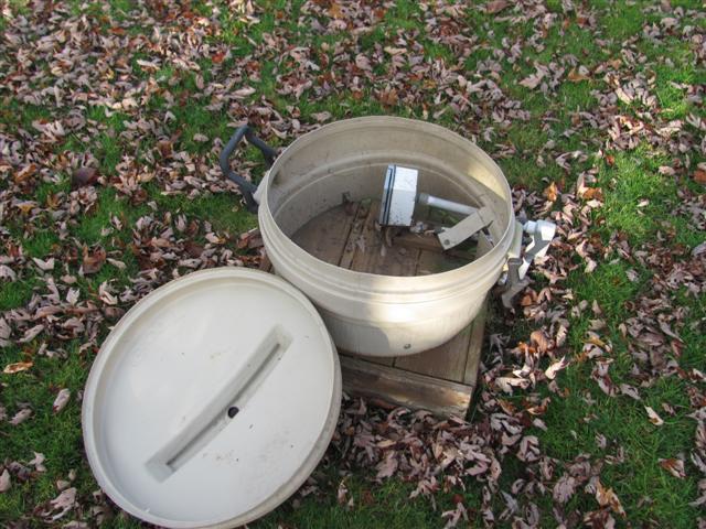

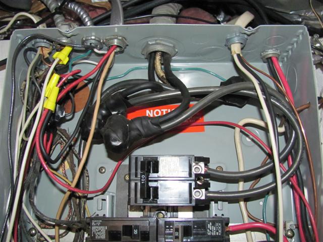

Spiced SEC/Service Size
1951 House.
Older Service Drop/Attachment/Meter
Updated panel 100 amps.
Spliced SEC in panel. Looks to me like they spliced the older 60Amp SEC with 100 amps to accommodate the main breaker.
I am calling it out a 60 amps and deferring to an qualified electrical contractor.
The only wire I could see was the grounded conductor at the service point.
What do you say!!

10-4 Dave…Over~Amped…may cook the little conductor----:smiley:
Well now, I’m gettin hungry. SEC: SpicyEdibleConductor ??

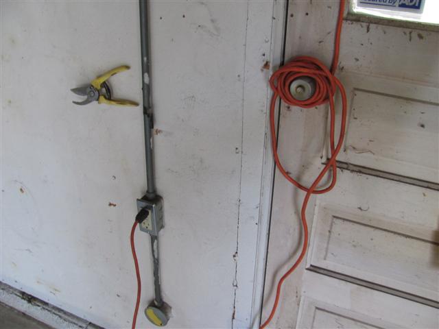

The agents stated this house had no violations from the local jurisdiction.
(Sure right, I need to apply for a city job)
This passed inspection. How could he not see the 10 ft. of extension cord on the garage service door. (Probably did not go in garage)
Ahhh the old extension cord door closer. Fling the door open, rebound closed.
