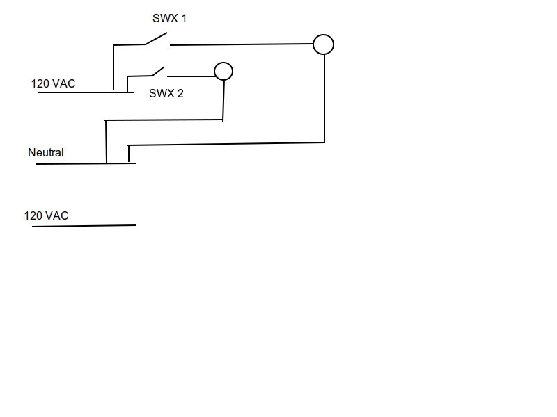

Splicing in the enclosure is permitted under various circumstances and various reasons. However splicing two neutrals together and pigtailing them to the neutral connection point is not specifically permitted and is quite frankly dangerous and sloppy work. So far we have not been provided with any specific NEC references allowing the condition in your picture but there are plenty of references disallowing it.

First we will look at a properly wired circuit with each neutral landing on its own lug on the terminal bar (see diagram above). These are all simplistic diagrams only for illustrative purposes. I’ve left out the over current protection devices (OCPD, breakers but just expect they are there). In this case if you lose the connection to the neutral tie point in the enclosure, and as long as it is not shorting somewhere else, all you have is an open and dead circuit.
https://www.nachi.org/forum/attachment.php?attachmentid=204006&stc=1&d=1539539644
Now we will look at the condition when two neutral, ungrounded conductors are wirenutted together and pigtailed to the neutral terminal bar. First we have absolutely no idea what those branch circuits are truly for and how they have been installed/wired in the home. You should always err on the side of caution and expect they are just two common branch circuits for lighting, outlets, etc.
  • In your picture the first issue was brought up by Roy about the potential for overload on the pigtail. We have no idea what the branch circuits contain as far as load/current draw. The pigtail does appear to be the same gauge wire as both of those branch circuits.
  • The second issue can occur if the pigtail connection was to fail for whatever reason but the supply side connections remain. If you close only one of the two switches nothing is going to happen. Close both switches and you created a path back to the supply side and the same buss it originated from instead of the proper return path.
https://www.nachi.org/forum/attachment.php?attachmentid=204007&stc=1&d=1539539706
Now we look at the conditions with each branch on a different buss/phase. Loose the pigtail connection and you now have a 240 VAC branch circuit instead of a proper 120 VAC branch circuit. You will most likely be, at the least, dropping/damaging anything connected to those branch circuits until either the OCPD in the panel trips or something burns out (lights, outlet, TV, or whatever is connected to it) to open the path. Hopefully no fire results from it.

The very first is NEC 408.41 (see above) that is a basic safety requirement. This is intended mostly to protect the person working on the panel from leaving the second circuit energized while isolating the one being removed for testing. This is the reference that specifically prohibits this condition in your picture.

As I stated near the beginning of this thread two spliced and pigtailed neutrals on the same circuit are not a hazard, it’s no different than splicing three cables in a junction box. Two spliced neutrals on circuits of the opposite phase are not a hazard as they simply create a multi-wire branch circuit (MWBC) which may have other requirements.
