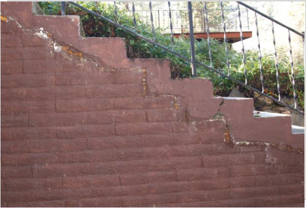

I am under the impression that these are cracks due to the stairs settling & shifting& that is why the stairs lean to the right. I recommend a sealant be placed along the cracks to prevent further cracking and prevent the woodpeckers from putting more acorns in them. However the real estate agent has told me that it is incorrect & the cracks are for drainage.

Walls like this need proper drains put in to relieve the pressure.
My report would be .
Looks like wall has a sever moisture concern and needs to be immediately evaluated and repaired if needed by a qualified Contractor.

Note: Drains typically are installed at the bottom of a wall, not the top!

Irrelevent of the cracking, the stairs “leaning to the right” is cause to call it out, and is not your concern as to prescribe a fix. You did your job, report what you see, being very specific as to CYA, and your client will make their decision as to what they wish to do about it.
Btw… sealant WILL NOT prevent further cracking. Do NOT offer a fix to anything. You are only asking for trouble!
If the cracks were for drainage, the water would run over the brick wall, causing deterioration to the bricks.
If the cracks are sealed good enough to retain the water (they won’t be), then the water pressure would build behind the wall, causing it to lean, fall, or deteriorate.
There should be weep holes near the bottom.
The RE agent and her contractor husband are wrong, it’s all wrong, and the stairs are starting to lean.

The drainage holes, if any, should be located near the bottom. Water, like the B.S. that agent gave you all runs downhill. That wall is over 4 foot tall and would technically be considered a retaining wall in most jurisdictions. Every effort should be made to keep ALL water away from any retaining wall.
