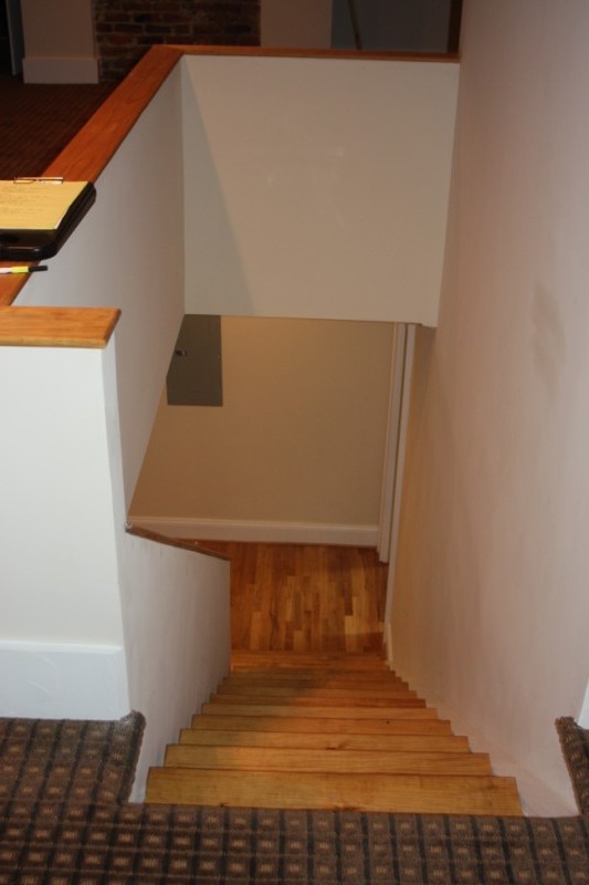

I’ll have a better idea of the situation tomorrow afternoon. This was a flipped house (usually a nightmare inspection), the attic was converted into a “loft” so to speak, and these stairs lead to the loft.
Ok, here’s the stairs as looking down from the loft. I recommended a rail on the wall as a minimum.

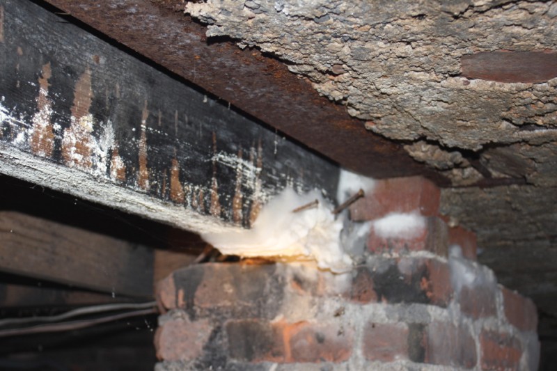

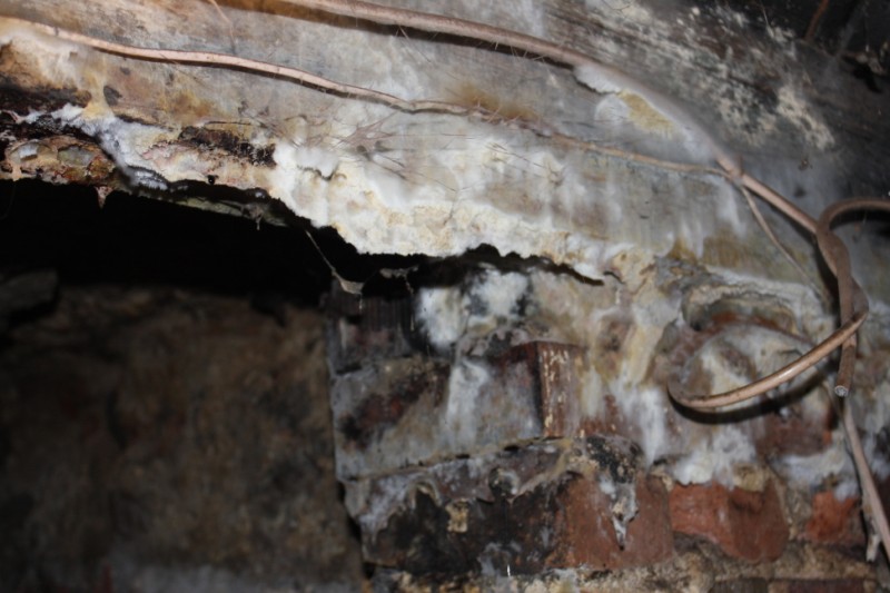

Besides, the stairs ended up being the least of their worries. Plus the electrician never grounded the system. The rod was driven and the copper ran for about 6’, attached to nothing.
Just a little growth! :mrgreen:
Did it taste like mold? :twisted:
Nothin better than a mold samich! :stuck_out_tongue:
Did you use your IR camera? You got to wonder what’s behind that pretty drywall.
