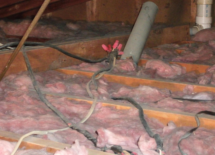

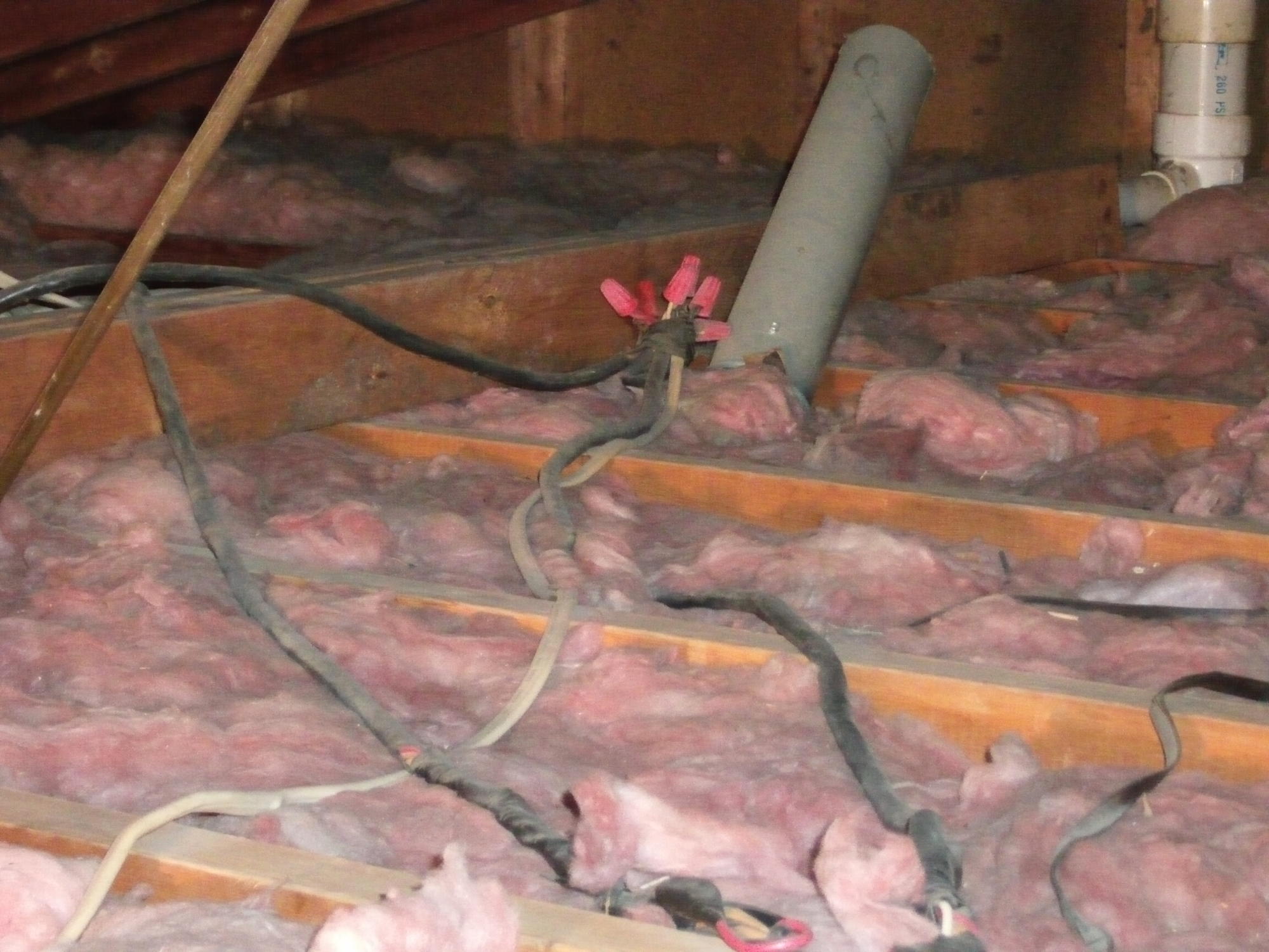

At this attic inspection(which covers multi systems) I have found multiple issues.
There is a minimum of insulation installed in this attic, I would advise the customer to have insulation installed to an rating of r30 for this climate, for energy savings.
i would also advise this customer to have the bathroom vent extended to terminate at the roof sheathing and to a roof jack. I would advise them to have either a qualified handyman repair this.
Finally i would advise this customer to have a qualified electrician come in to add a junction box with a cover for the splices in the attic. And check for more open spices.
