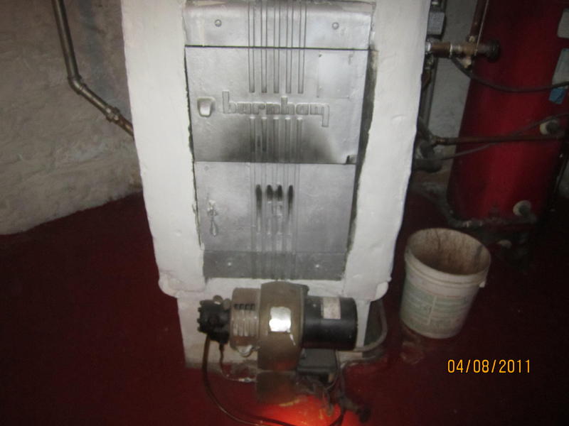

Did a recent inspection in a house with a steam heating system. Boiler is located at the basement level. Basement is living space. There are no radiators at the basement level. The only heat “source” in the basement are the steam pipes that run across the ceiling of the basement. They were boxed out in bulkhead with a grill at the bottom presumably to allow heat into the room. Are these steam pipes considered a “heat source”? My senses tell me this is inadequate but would like to hear other opinions on this.

Write it up that you were unable to test it due to its being locked and recommend that it be evaluated by a licensed HVAC tech prior to close of escrow.
That’s pretty much what I’m going to say. How old do you think this boiler is. House was built in 1905 in case you were wondering.
1905
Was I right? What did I win?

You might be right if Burnham boilers were around that long.
That boiler is probably insulated with asbestos which is no problem as long as it’s not disturbed. What I find in a lot of old homes is that the insulation on the pipes is damaged or missing. If it’s missing or non existent as you describe, was it properly abated or are those boxed out pipe chases contaminated?

I agree with all of your comments guys. Definitely asbestos wrapped, probably won’t provide sufficient heat at 36" above the floor, and I was sure to tell my client that the heat source was questionably adequate.
