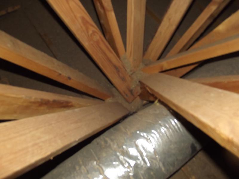

Strange McHammer
Weird construction technique never observed roof supported in this manner
Sure I have seen that Charley it is called a single point load. What size of column was under that area. LOL
Don’t know it was buried and I don 't dig in insulation just never seen one like that in the flat lands
Charley under the point load in the house. Was it a support wall or large column.
No load bearning wall beneath
Can’t imagine Charley, why that configuration and the tripple ceiling joist under those struts.
Hip roof, and not required by my knowledge. But there is a first for everything.
Looks like a tree of temporary supports never taken down. Certainly don’t need that for a hip roof framing.
Weird at the least.

Framing sucks…hope you wrote that up.
So what would you have stated tear it down and start over???

I think it is quite an unorthodox method of providing additional support for undersized rafters for the span.:slight_smile:
way too polite…
not at all pretty but it’s OKIE and i see no T-brace(s)
fyi: unbraced length of struts shall not exceed 8 feet (2438 mm)
get the dummy up there to fix it ;~))
Bracing is a joke…undersize braces and purlins, incorrect spacing…the list goes on and on.
In cases like this its best to simply write that the roof framing system was improperly constructed, recommend a licensed general contractor correct same. Repairs will run around $2000.00. The biggest pain is dealing with the heat… I would want to start around 6am and hope to be out of there by 11 am…and pray that my guys don’t fall through the ceiling make the job a complete bust.
