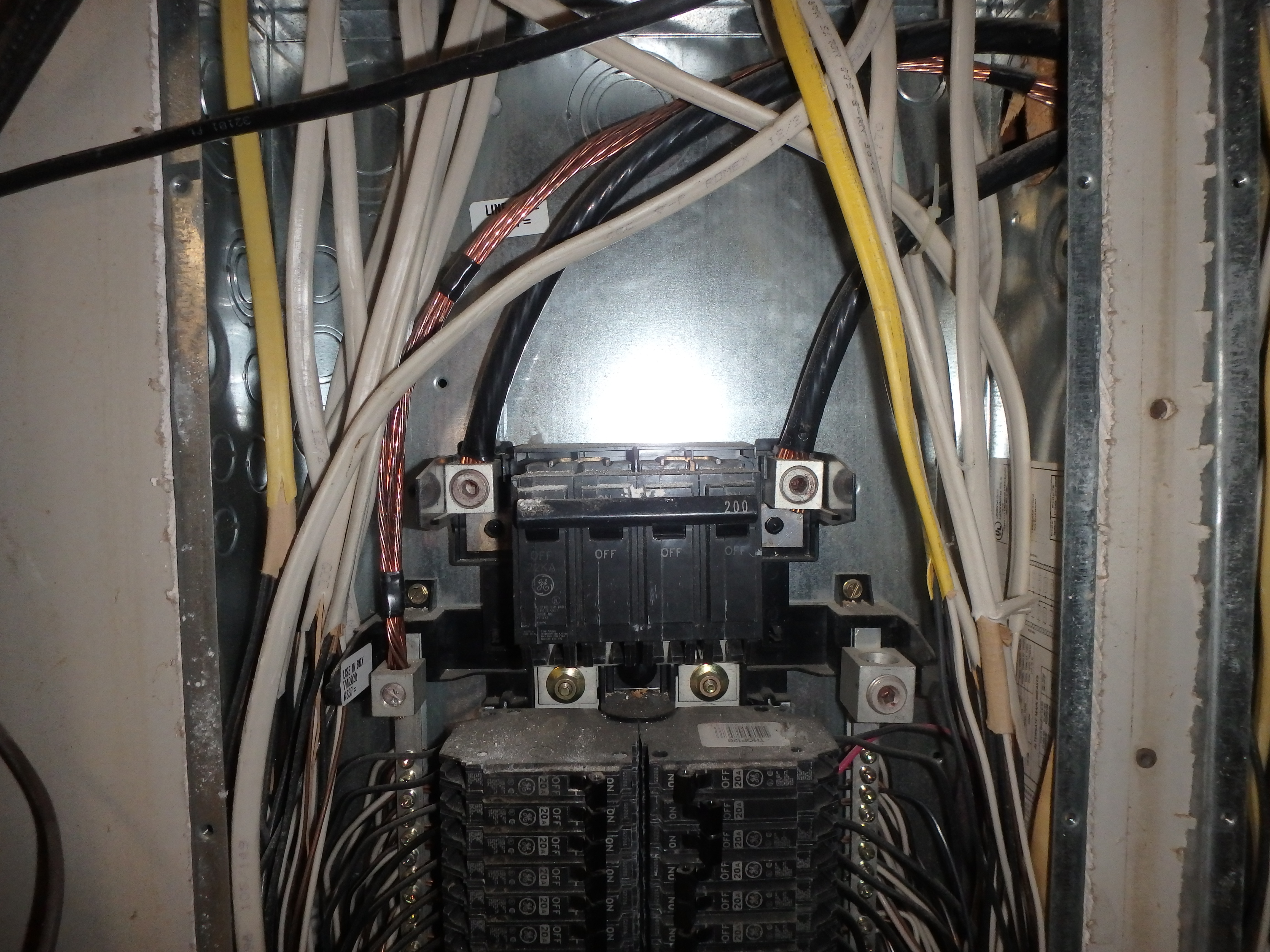

Need a little help on this, as I have never seen this done before. Overview:
There is one meter on exterior wall and 3 separate GE panels each with 200 amp mains inside
SEC conductors enter the panel on the right and the two hots are spliced and the spliced conductors ‘daisy-chain’ to the middle panel. The neutral lands on the neutral buss. A braided bare copper conductor leaves the right ground buss and travels to the middle panel neutral buss. The two hots on the middle panel are spliced and the spliced conductors ‘daisy-chain’ to the left panel. Another braided bare copper conductor leaves the middle panel ground buss and travels to the left panel ground buss. There is a ton of other stuff going on, but it is the service conductors that have me unsure.
Any explanation would be appreciated!
The meter feeds the panel at the right. The service entrance conductors (SEC’s) are spliced and feed the panels to the left as you’ve stated in a “daisy chain”. The paralleled twisted bare conductors are a violation. A load calculation would be needed to determine if the SEC’s from the meter are the correct size.
Short answer its a no-go.
Imagine the main service coming from the meter with 597 amps on it before any of the 200 amp breakers trip (199 each). definitely overloaded, incorrect multi taps on main lugs…, I cant imagine the main bieng rated to handle that.

well with the daisy chain configuration (looks like that), the main 200 amp breaker will not interrupt service until it reached 200 amp capacity. Each panel has a 200 amp breaker present.
in that case, if each panel drew 199 amps the 200 amp breakers would allow it, the main coming in looks too small gauge to handle the load of all three prior to tripping. Fire hazard.
The other poster is right, have a licensed electrician doing a load calculation to be 100% sure but I believe its wrong here.
Since the panels are all connected together and fed from the first panel, wouldn’t a combined amperage of the last two panels of over 200amps trip the first 200amp breaker or the 200 amp main disconnect if there is one.?
I don’t think so. The daisy chains are all junctioned before (on top of ) each breaker. So the far right panel main feed could be exposed to over 200 amps.

Yes Mike has it correct, those splices are ahead of the 200 amp circuit breakers so there is no OCPD protecting the combined load of all three panels coming from the meter. While the combined rating of the three service disconnects (3*200= 600 amps) is permitted to exceed the size of the service entrance conductors (SEC’s) the calculated load cannot exceed the ampacity of the service entrance conductors.
Hey David - I don’t want to throw more soup on the pie (<grandpa used to say that. ), and I may be seeing things wrong - but it looks like you have a portable generator inlet w/backfeed running to bottom right of the left panel (30A breaker?). Can’t do it. Gen breaker has to be at top and closest to main breaker with a mechanical interlock (lockout device). Just sayin. :flushed:
Hard to tell from the photo but isn’t that just a 50 amp receptacle?
Looks like it may just be a welder’s receptacle.
There was a welder in the garage.

The other two panels are not downstream of the main disconnect in the rightmost panel. All three panels are “service equipment” a more technically correct term than “main panel” Each panel is configured to be able to draw 200A, individually. The SEC is not sized for the potential aggregate load.
As wired, they are all service equipment as none are downstream (i.e., on the load side) of a disconnect.
The required working space is measured from the front of the equipment, so the working spaces can overlap, provided all covers can be opened a full 90° (NEC 110.26)
