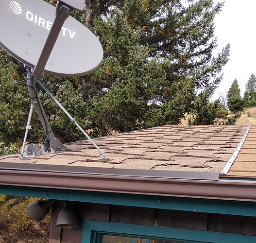

Strange patch job on roof
Any ideas on this one? I’ll also note the flashing at the end is fastened on the top of the shingles.
those are T-lock shingles and a T-bar screwed in between the 2 roofs.
The T-bar is what is used on rubber and TPO roofs to fasten it to the fascia side of the roof.
at the bottom looks like straight bend drip edge used for flat roofs. but fastened to the top of shingles.
everything here is completely wrong. Just recommend a Roofer to evaluate.
The roof also appears to flat for shingles anyway.
