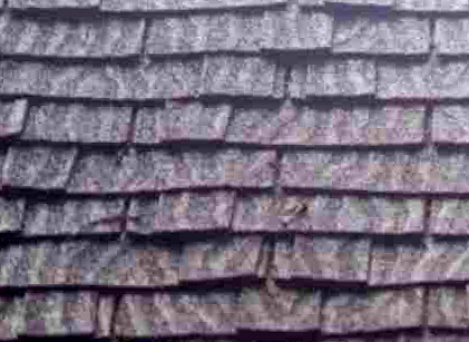

Strange wear to shingles

This is what we installed but I cant find the name or brand anywhere. Now I am consumed and will remember at 2:45 am sometime next year. Not that it will be relevant now or later.:mrgreen:

Hey richard my best guess is defetive shingle. was this installed around the eraly eities? I know there were some that were made wrong about that time.

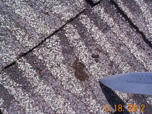

It appears to be a failure of the asphalt layer… delamination… and it appears to have a somewhat uniform pattern resembling tiger stripes. It could be a manufacturing defect caused by problems with the drums/rollers in the production line.
If it were poor quality asphalt, I’d expect to see less uniformity.
Either way, I’d say it appears to be at the end of its useful life.

I found this image in my photo library. Look familiar? This shows a tiger pattern with two different colored granules, except that it’s just beginning to delaminate.
I don’t know where I got this. Anyone claim it as theirs?
The question is… on Richard’s roof, was asphalt exposed or is the color variation caused by granule color?
Its a manufacturing defect. When the granulate was applied the jets spraying on glue or adhesive was improperly adjusted or nearing its end of the batch.
Calculations to adhesive to material ratio was missed or that was the end of that line of shingles and they were not properly sampled for quality control.
