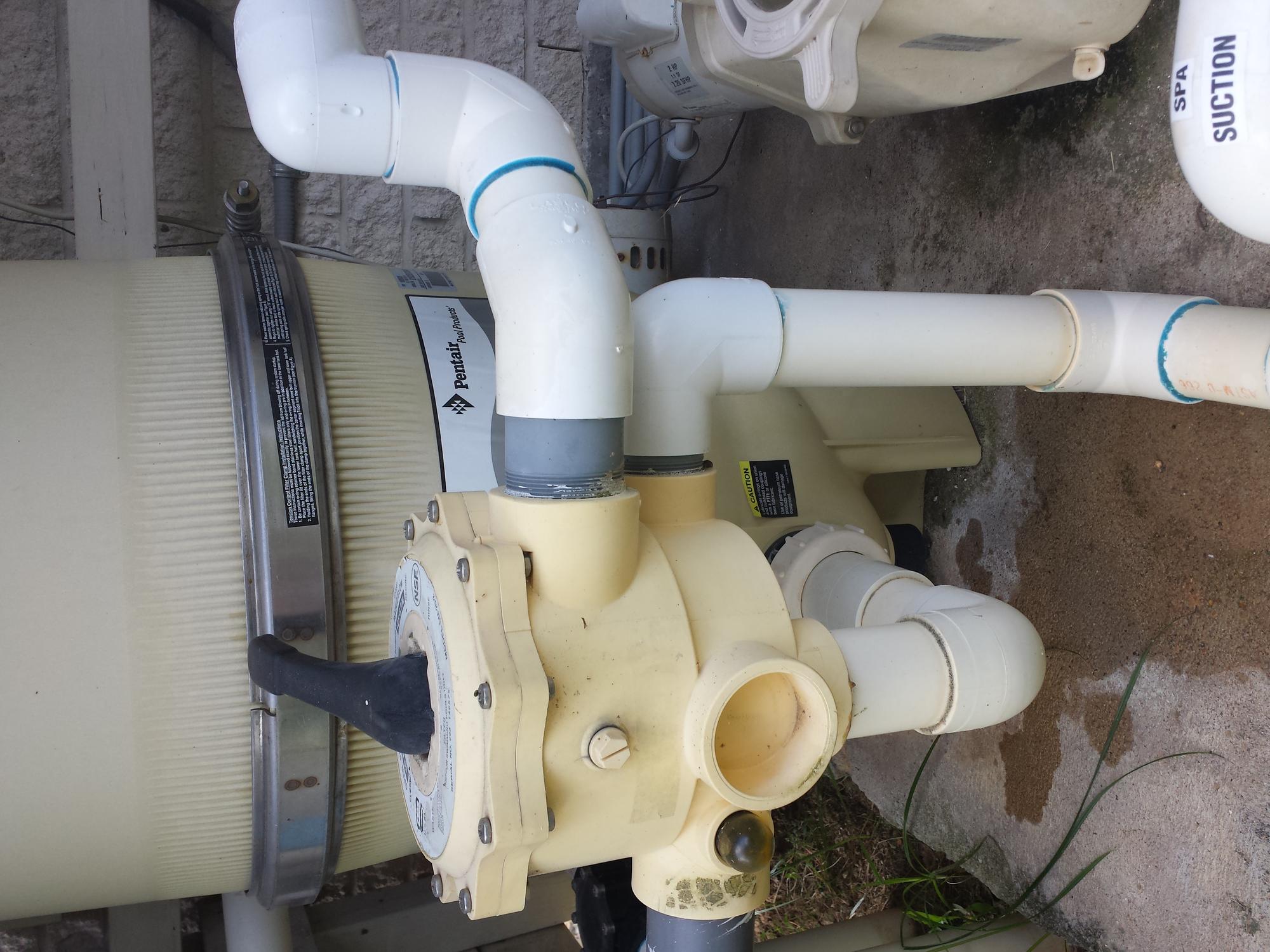

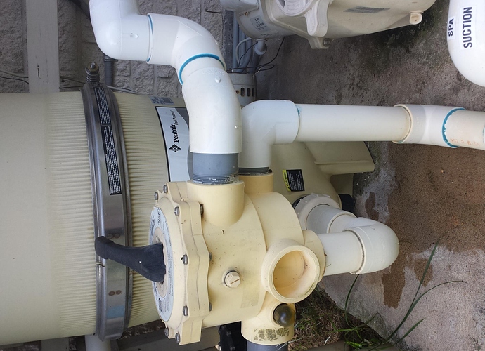

This is a photo of the multi-port valve or 3-way valve, that is connected to the front of the pool filter.
This valve controls the flow of water for the pool circulation, filtering, as well as backwashing. The water is pulled by the pump and pushed through the valve into the filter and is sent back to the pool in the return line.
The valve appears to be functioning properly, with smooth operation. After a visual inspection of the pipes, I found a small leak in the connection between the valve and the return pipe. Further evaluation is needed by a certified professional.

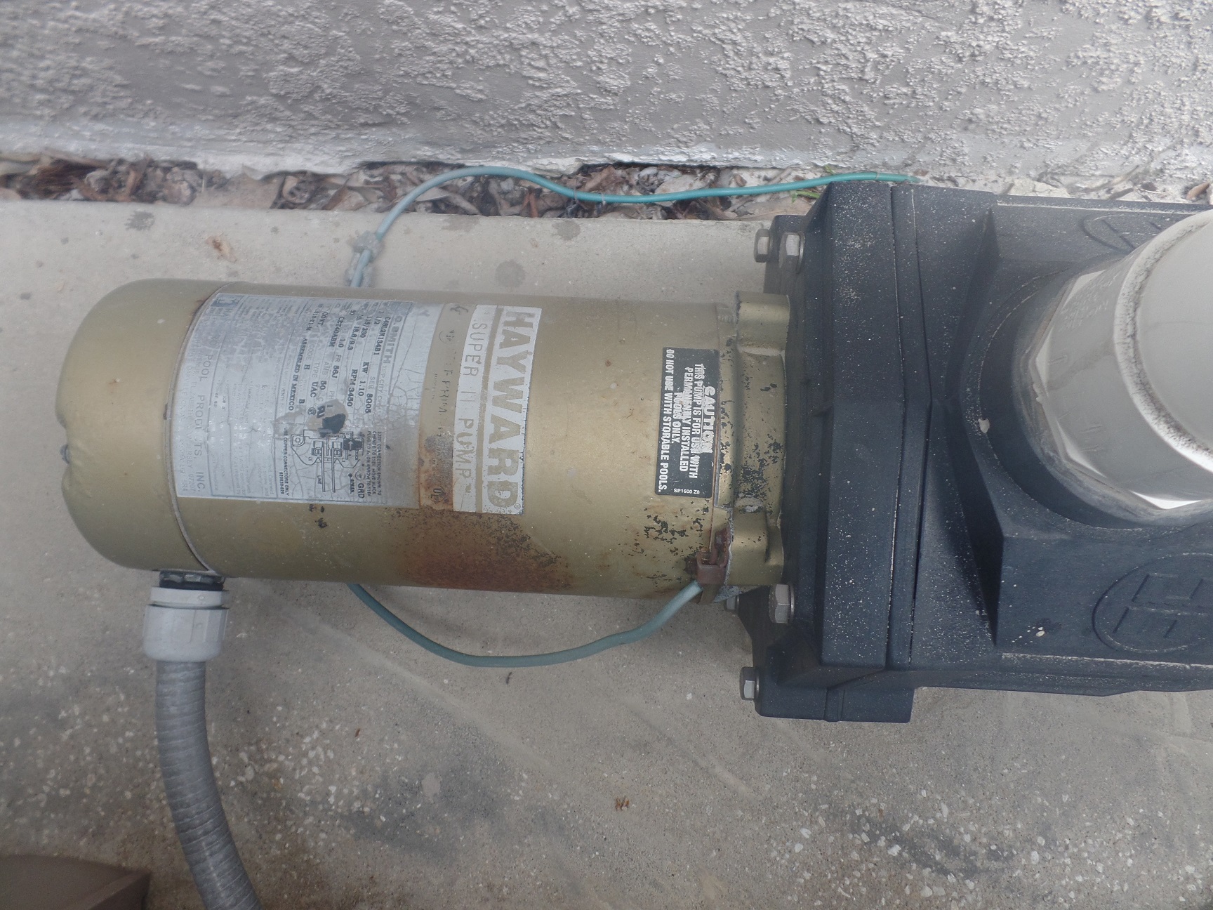

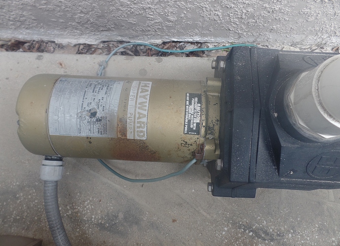

this is hayward centrifugal pump with strainer pot, the unit is properly grounded and pump casing has evidence of rust and wear there was minor noise from motor but no signs of leakage, recommend certified pool contractor for further evaluation

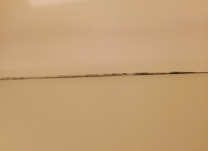

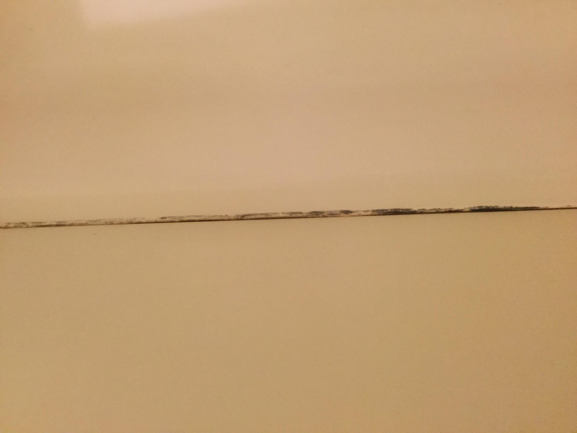

I don’t have any photos of pool or spa equipment but I found one of some mildew in a shower basin. I always recommend that clients have mildewy caulk replaced with mildew resistant caulk. I also recommend they have the affected area looked at more closely for signs of water penetration and damage before the new caulk is applied.
