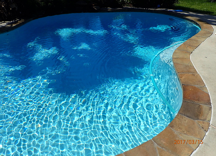

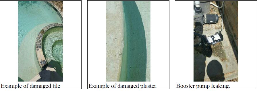

On March 19, 2017, I accompanied a professional home inspector to inspect a home with a pool. The inspection found the following issues with the pool:
  1. Extensive corrosion and chipping of plaster.
  2. Pool pump and filter were leaking
  3. Damaged tile around the pool.
    We recommended further evaluation by a qualified pool professional.

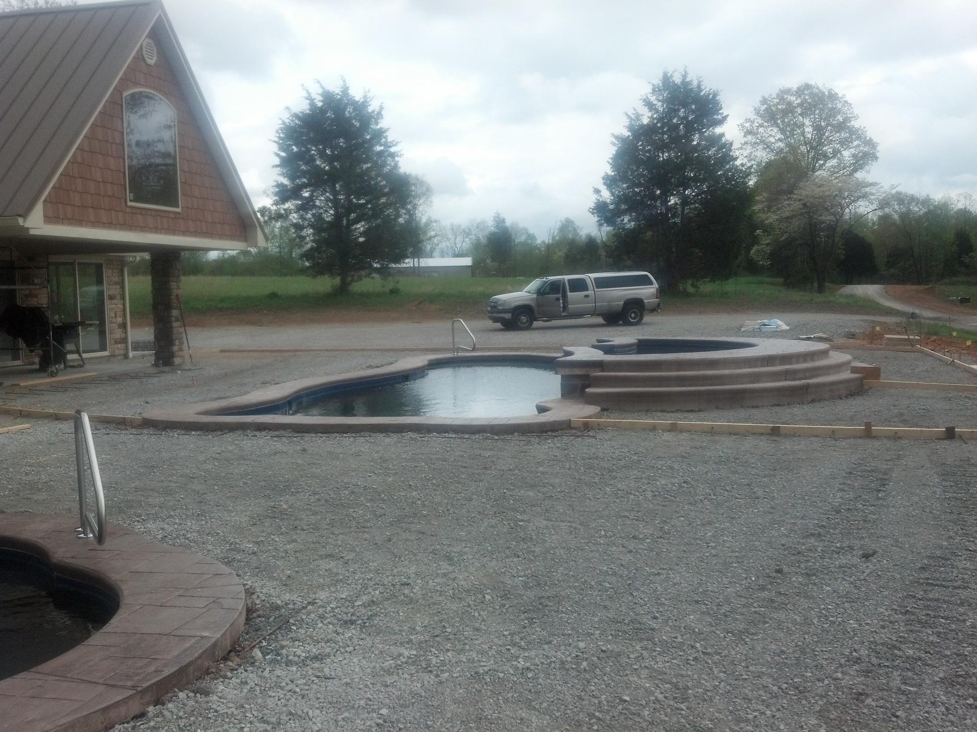

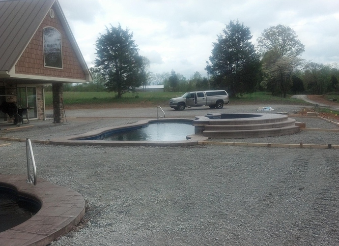

The picture I’m providing shows two Pool Vessels and a Tanning Ledge vessel that I provided Inspection and Project management services for the Property Owners. It was interesting dealing with a pre cast pool vessel in the past my involvement building pools were limited to gunite constructed pools.
I’m currently taking the ‘‘How to Inspect Pools and Spas’’ Coarse to be prepared to take the Tennessee State License. I’ve learned quite a bit about different construction practices used in this part of our country, I’m originalty from the west coast.

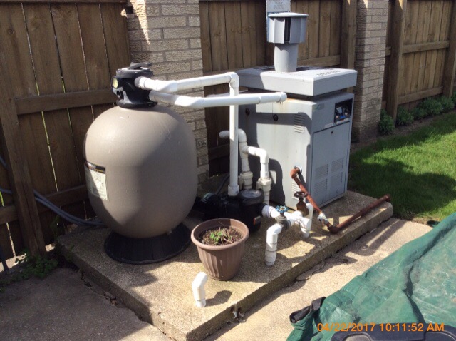

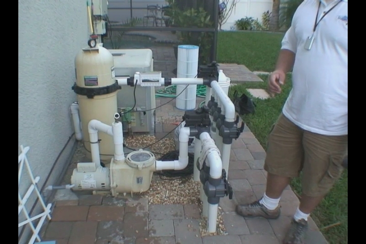

The image I chose to take a picture of is basically the heart of the swimming pool system, the pumb, as well as the different plumbing pipes, veins as I learned they are called. As you can see this system has a filter, which has a gauge mounted on top. It does appear that this is all schedule 40 PVC as it should be. You can also see all the different valves and such. The pressure relief valve is also installed in the plumbing system as it should be. I did not get all the pump info, or the BTU’s of the heater, however I know to do that when performing a pool inspection.

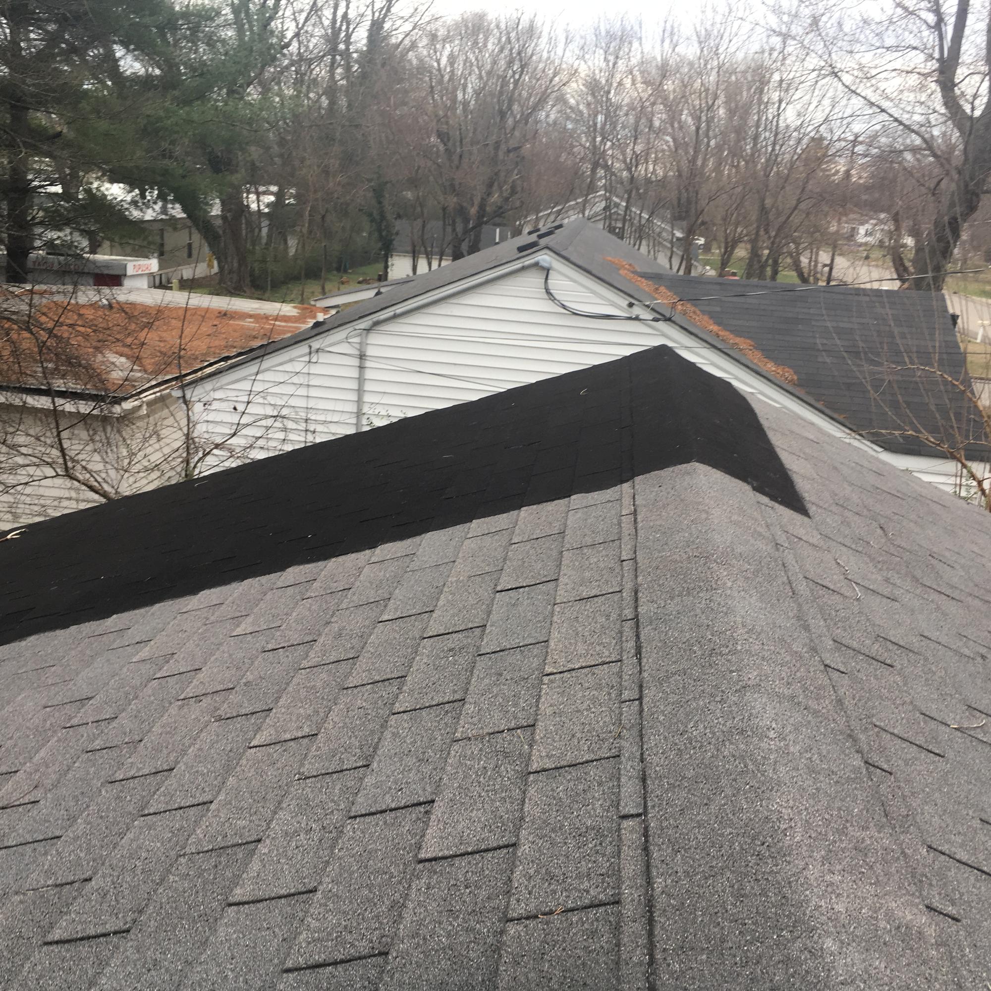

During my last ride along inspection guidance by one of my mentors we stopped by my home for lunch. We broke out the extension ladder, and set it up at the back of my home using the 4-to-1 rule for safety. Once we were up on the roof we could see the recent repairs that had been made to the roof after a tree branch had fallen through two years prior. I had already been inside of the attic space by usage of the interior drop down ladder located in the hallway near the bathroom on the inside of the home. The inside of the attic area below the repaired section did not show any signs of moisture intrusion, but a walk upon the roof was necessary. The repair of the roof was adequately done, but the usage of a tar sealant is showing signs of wear. It would be recommended to have this roof replaced as there is some signs of the shingles deteriorating naturally as we found small shingle particles in the gutter system.
