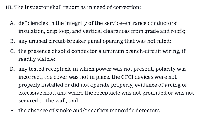

Hello and good day. I am so confused and would like some clarification please. On page 11 of the “how to perform residential electrical inspections course textbook” it states: “According to the InterNACHI® Home Inspection Standards of Practice, a home inspector is
not required to do anything that the inspector thinks is unsafe, including removing dead front
covers from electrical cabinets or panelboards and exposing electrified, “live,” or “hot”
electrical components within.”

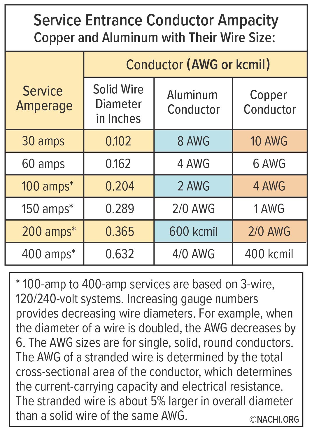

Question about this chart from Part 2 of the Service Entrance Cable section of the course. Shouldn’t the sizes for the largest two aluminum conductors be swapped, as 600 kcmil (listed for the 200 amp service) is larger than 4/0 AWG (listed for the 400 amp service)?
Yes you’re correct, for a 200 amp service #4/0 aluminum would be the minimum size and for a 400 amp service 600 kcmil aluminum would also be the minimum size.
I had the same thought as Trevor when I viewed the video. I am still not clear on the answer. Is it expected/standard practice to remove the Dead Front panel IF NO HAZARDS are observed?
Yes… … …from my perspective.
Larry is that part of the SOP?
The SOP only addresses “not required to” and “SHALL":
My perspective is it expected and a standard practice that it will be opened if safe to do so because that is where the “SHALL” anomalies are found.
What is your perspective as an electrician, Rob?
Here’s the SOP:
As someone who has bought several homes and always used HI’s I would feel like I was getting ripped off if they didn’t open the cover and look inside. Having said that I would do my own inspection too because the electrical panel seems to be an area where a lot of safety issues can be found. And something like a burnt bus which would require the panel to be replaced will cost the buyer a lot of money if were missed during the inspection.
