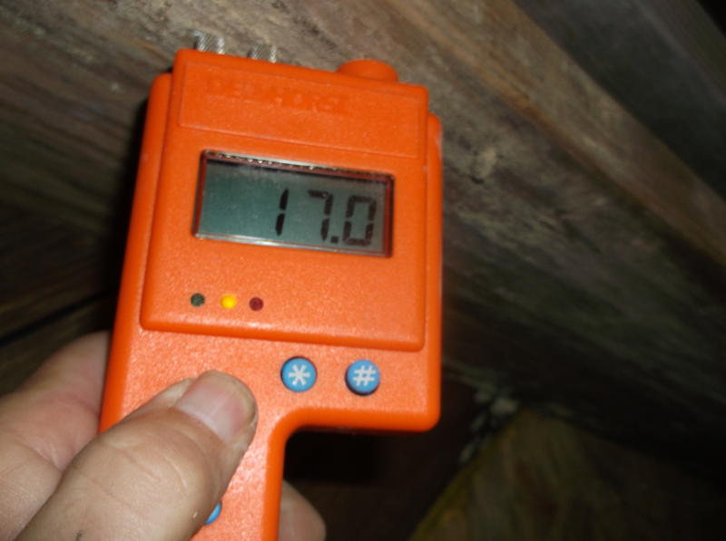

This is a photo I took in crawlspace with very high RH. Almost every surface had condensation. This was the result of no vapor barrier on the bare ground and essentially no ventilation.
Many builders(unlicensed) and home owners do not understand crawlspace ventilation and vapor barriers. Also proper crawlspace grading for the exterior. In the deep south, I see houses built in the past had no enforced inspections or codes. Professional home inspectors are loved by most home buyers( we discover mold and decay and WDI activity at crawlspaces>often.
Use treated lumber for crawlspace framing and subfloor!!
