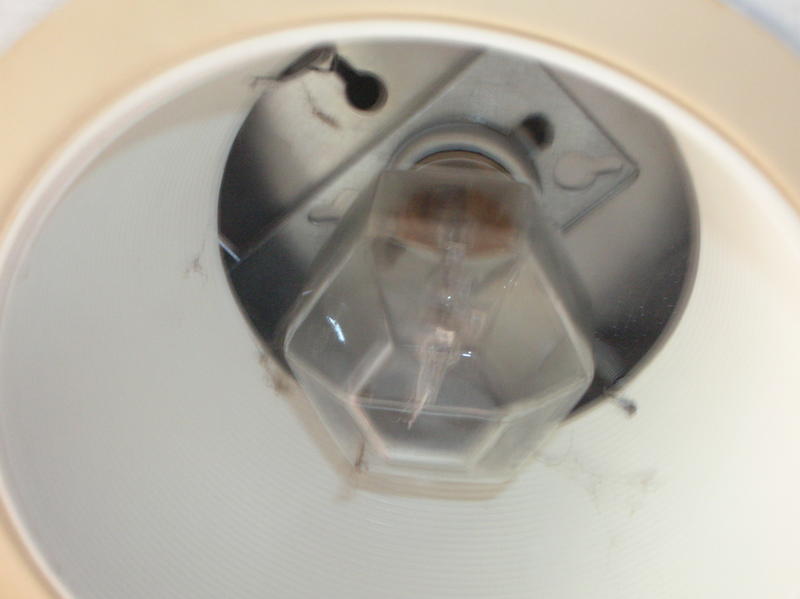

can lights in kitchen tested and have air leakage.lights show temperature drop of 510 degrees F.attic shows poor insulation and unsealed chases for conduit and wiring

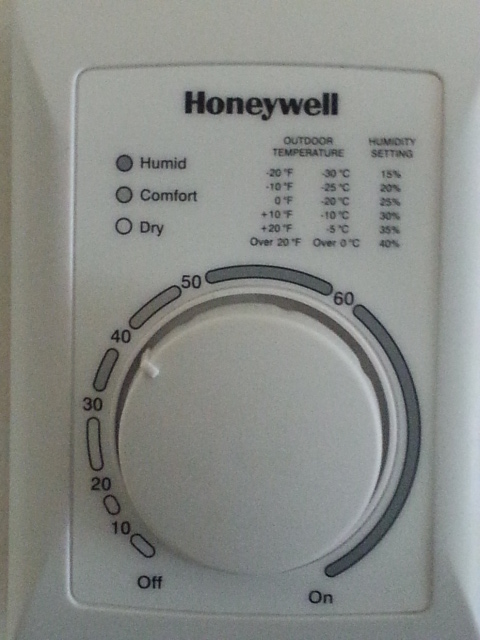

Here’s a picture of the humidistat I installed along with a whole house humidifier I installed this winter. Not the handy reference guide for approximate settings based on the outside temperature.

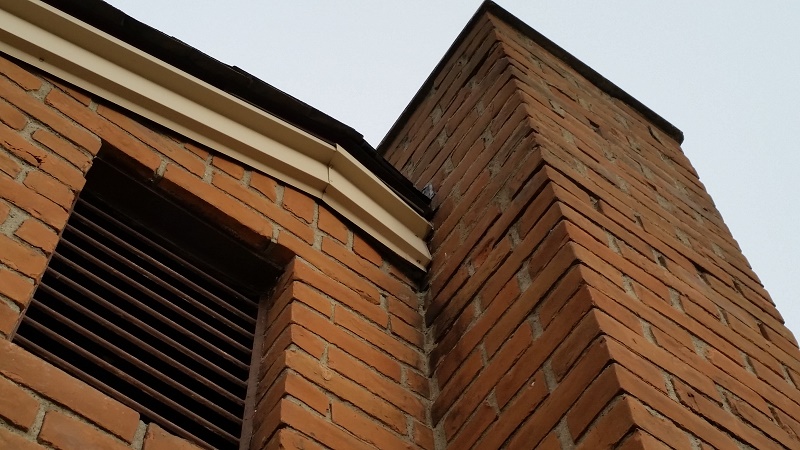

A chimney (and the chimney chase) very close to a gable vent presents some unique inspection observations.

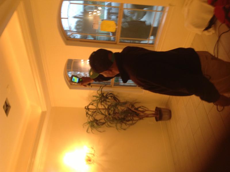

Checking for moisture.

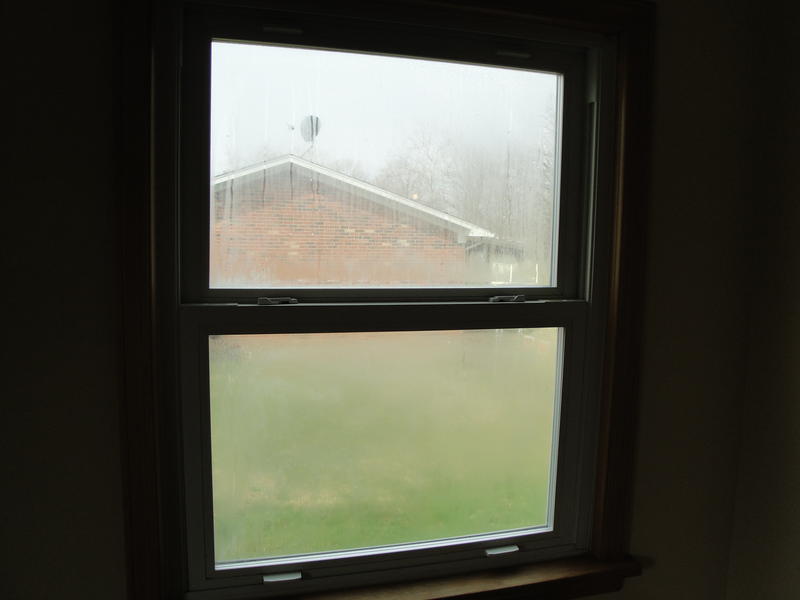

The window has a seal that has been compromised and as a result, condensation has formed between the panes of glass.

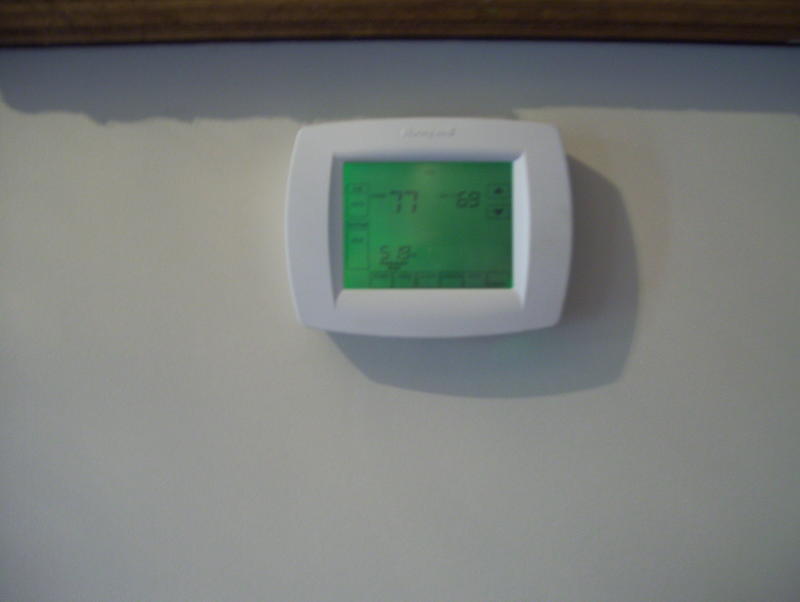

Hi everyone;

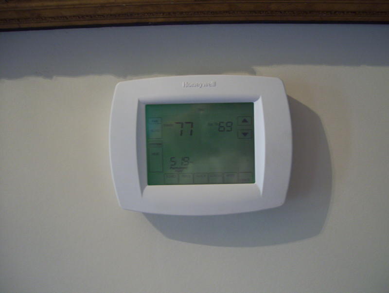

I would like to share two pictures of a modern Honeywell programmable thermostat. This thermostat is in a home that is only 6 months old. It controls a heat pump AC split system with an electric furnace backup. The thermostat has simple digital readout and controls. Honeywell has been manufacturing thermostats and other controls for a long time and is one of the leading American companys that produce heating/ cooling controls.

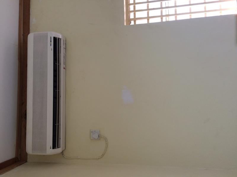

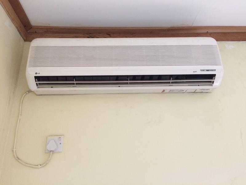

I took this picture while working in Africa. Most buildings here are not equipped with any central HVAC system. These room specific units do not control air movement and in the high humidity near the equator fail to control RH. Hence the moisture problems inside structures in this region of the world.
