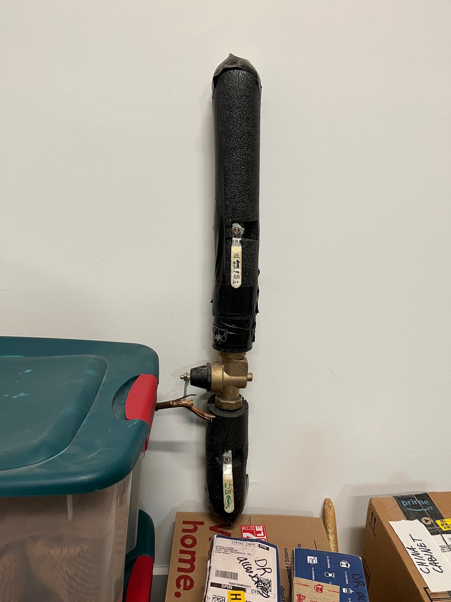

I have two questions:
  1. does a water heater require an expansion tank if the home is serviced by a private well?
  2. in the pic, is that a pressure reducing valve on the line with the main water shutoff valve?
    ![IMG_4446|375x500](upload://t1O5q3s60EjBOeoMKktleH7iOVp.jpeg
It depends to manufacturer of water heater.
If your system has a check valve you should definetely install a expension tank. The check valve protect your well contamination and at the same time your heated water can not expend toward to the well. I believe pumps have check valve anyway
looks like pressure reducing valve

I know this was 4 months ago and I’m sure you got your answer, but just in case I think it depends on the system having a check-valve or not. If its an older system, its possible there may not be a check-valve and the water can expand back into the public water plumbing. But not likely…The water heater water needs to expand when it gets hot. If it cant, then there is a problem. The TPR valve will leak or its possible the pressure will affect something else in the system like a leaky faucet. I have a well (private water source and have a lard expansion tank that holds 50ga. I definitely do not need an expansion tank on my water heater. I have seen them installed even when the home has a well and expansion tank. I guess its something more to bill for.
Look for a large blue expansion tank near the plumbing that comes in before it splits off. All wells should have one at the pressure switch to prevent the hammering effect of the pump turning off and on.
